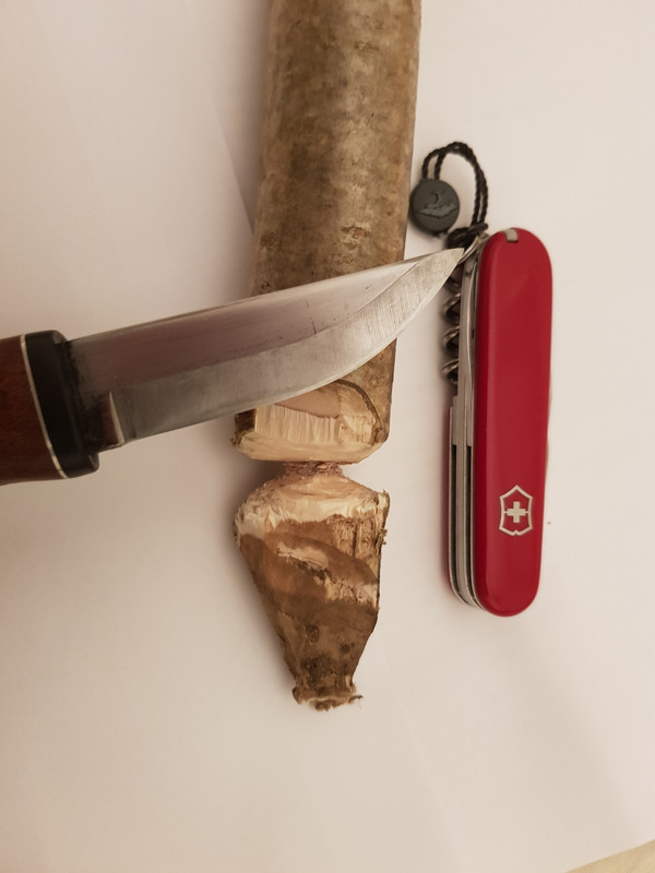

Pulling up this thread because I think it's the closest to what I want to post. 80CrV2.
Picked up a small no-name maker puukko with a Lauri 80CrV2 blade some time ago and just got around to putting it to some real use. Wow.
I had thinned-out the scandi edge on DMT plates up to 8000 mesh to a really thin profile and stropped with green compound to finish - this edge should flutter in a strong breeze!
And then I spent an hour or so whittling away on semi-hard hazel, appr. 1" diameter, doing push-cuts with a little forward twist at the end to remove the shavings, at both ends of the piece to remove the original rough-chopped ends...then de-barking the 16" length...etc.
In summary, over one hour of putting some real stress into a very thin edge, fully expecting some serious rolling or chips.
Nothing.
Nothing at all. Nada. Nichts. Niente. 100% exactly the same edge I started out with. Amazing. A sub-$10 blade with a home shop handle.
