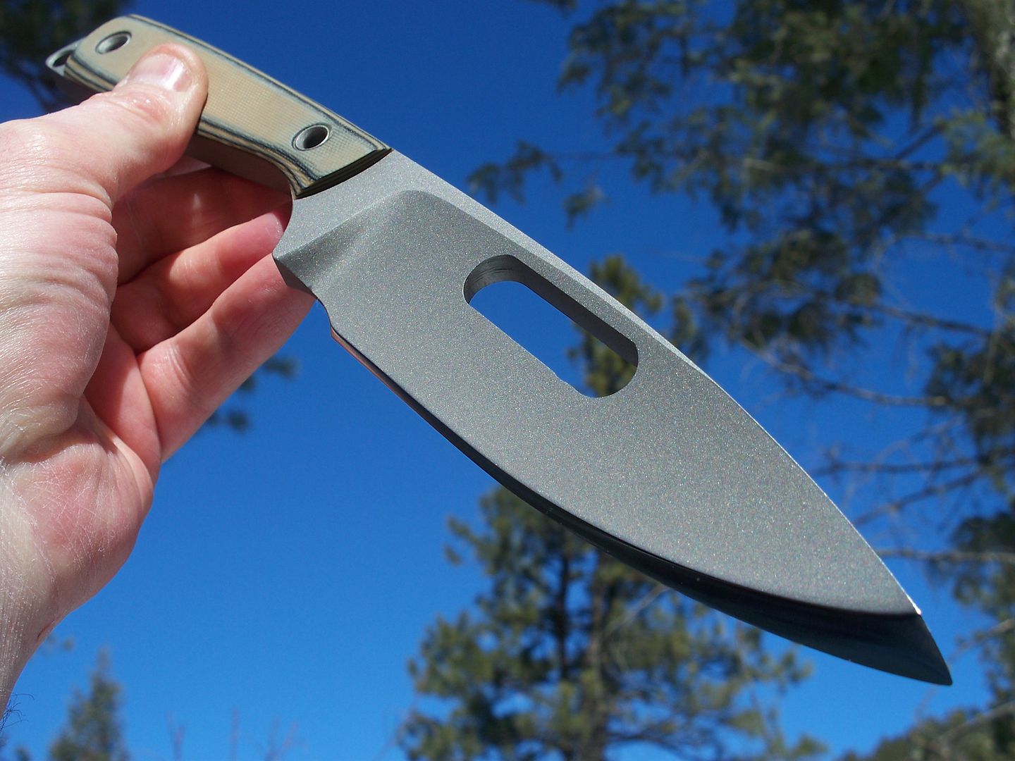

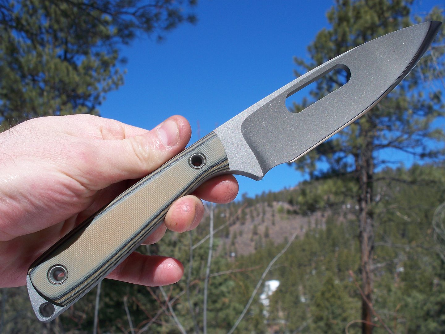

This one is about 11.38 long with a 6" blade including the choil.
MCAM G10 and .315" A2 Tool Steel

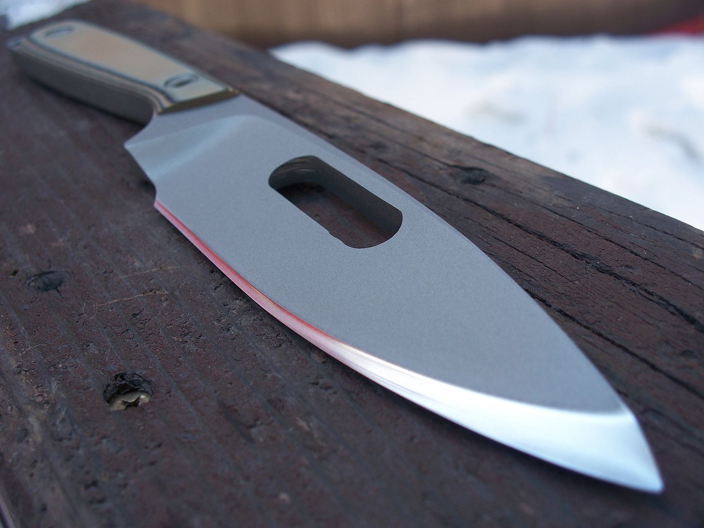

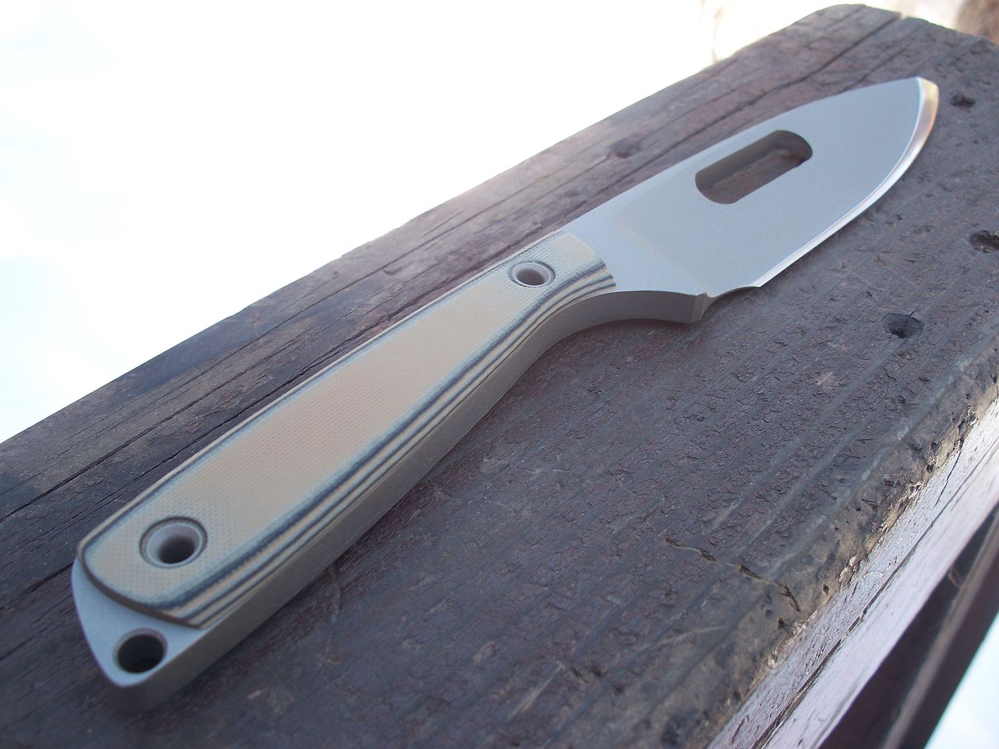

Turned out great Daniel. Love the bead blast finish.:thumbup:
Thanks! I really like the finish too, it looks so cool to me. The blasting had to help a ton with the epoxy bond and really brought out the texture in the G10, it's as grippy as it gets. The blasted tube may be my favorite part. I really wanted to keep it! :D

Nice score! It's big yet very light, I made it to carry.
Oh, so not a chopper at all huh? That's ok, looks like it'll still baton and slice well etc. Do you remember what HT hardness you did this one at Daniel? Is A2 difficult to care for? should i oil it if in storage for a while?
It will chop and generally do it all, is is more of a well balanced knife than a true chopper. ...Big knife for all around ability.
If I recall correctly it is hardened to about 59-60 for the best of toughness and edge holding.
It's .315" thick but will carry well in a sheath as the balance is excellent, lots of power...I made it with the Soldier in mind. ...it's an all around tough knife that can handle most tasks with ease.
I'd keep it oiled, the finish will really soak up oil which is nice. A2 is not stainless but has a bit more rust resistance than a carbon steel.
