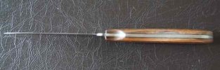

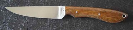

My first knife post. Hobby knife maker, getting back into it as I approach retirement.
Blade:
A2 Steel - .125" : OAL 9" w/ 4" blade : ~.875" wide : RC59-61 : HT completed by Peters
Handle: Jatuba w/stainless pins and tubing and black fiber liner. Attached w/West System G Flex Epoxy
I do not sharpen blades until sheath completed.
Constructive criticism much appreciated.
Thanks.
