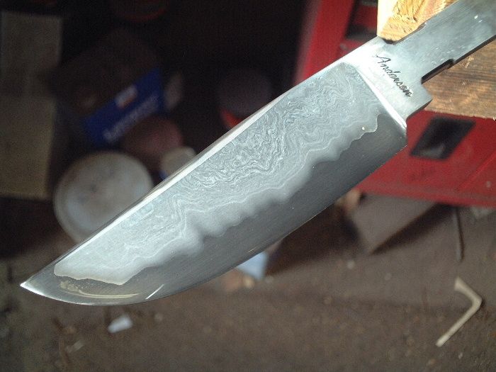

I was watching some Murray Carter videos and got to wondering how much if any corrosion resistance you might get using A203E as the cladding on a carbon san mail blade instead of plain mild steel? Does anyone have any experience with that?
I started using it when I began making San-mai.
Rusts like a bitch.
It has some cool character though.

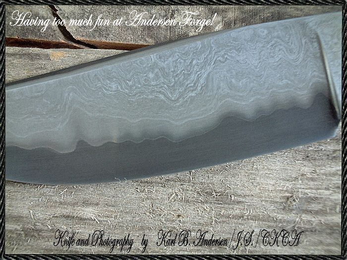

This is 203E:
Karl, what did you use for the "dark" steel in the cladding mix? For a "softer" damascus cladding, would I be as well off using 1018 and 15N20 which I already have in quantity?
The core is 1095.
Not sure what you mean by softer. It doesn't harden. 203E is basically 1018 with some nickel. It was the go-to nickel bearing steel in early Damascus making days. It was mostly used with W2 when it was readily available. In the right proportions and up to about 300 layers, you'd get about a 1084 blade after migration.

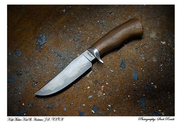

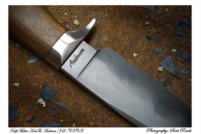

Wow! You even get a bit of a "transition" without using the pure nickel barrier. That is cool looking.How thick are the pieces when you start out?
I've never used any nickel in my San-mai. I never understood the purpose of using it.
I use 3/8" 1095 as my core and 1/4+" 410 stainless in my normal offering of San-mai.
This stuff shown here in the previous pictures - which, keep in mind I haven't used in over 6 years - was 1/4" that I got from Admiral Steel.
