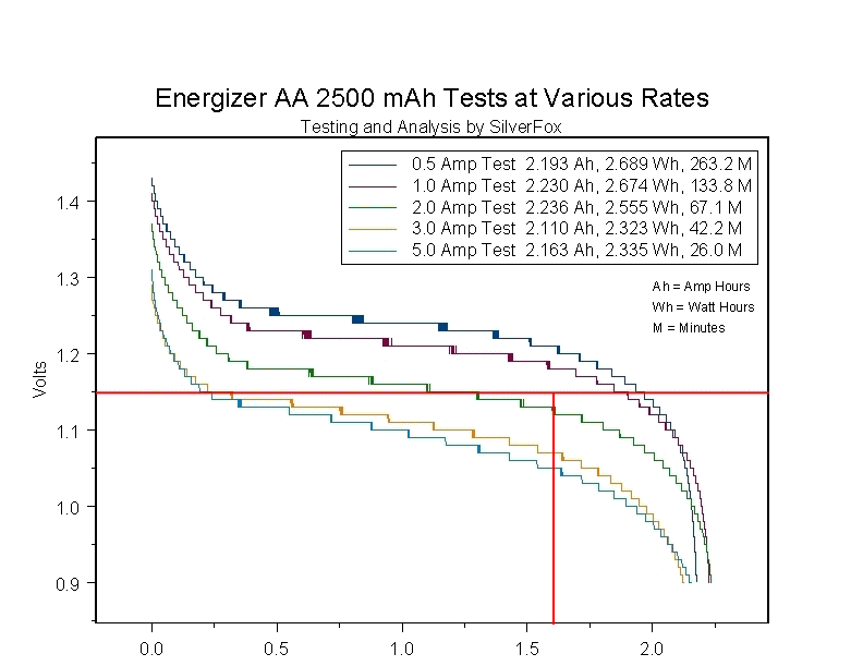

How often are you charging them? Those have a pretty awful reputation as far as self-discharge rate goes.I like my Energizers. 2500 mAh
http://www.candlepowerforums.com/vb/showthread.php?t=204139&highlight=Energizer+2500
http://www.candlepowerforums.com/vb/showthread.php?t=160139&highlight=Energizer+2500

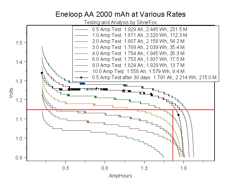

Brand new hi-cap cells will still have a higher capacity before sitting 1 or 2 months than an Eneloop, as noted by UnknownVT, but that is when they are still at the peak of their life. After enough cycles and usage that becomes less and less so. After a few months (maybe a year?) of use, the self-discharge rate becomes worse. That is when you start to hear the stories of, "I charged my cells on Friday and when I tried to use them on Tuesday they were dead."
Sanyo Eneloops
You won't be sorry: I know I haven't been.
