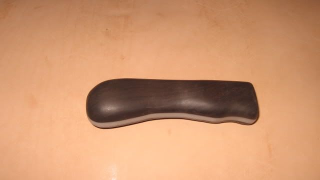

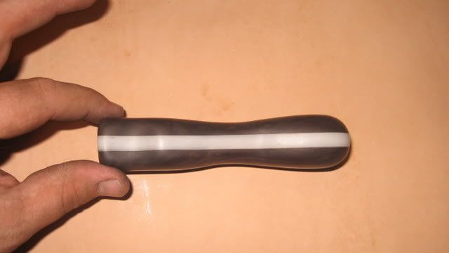

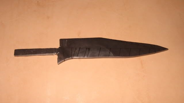

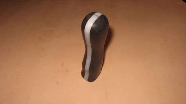

Aaarrrgghh!!!! I was cutting a blade, my first knife also, with a cheap dremel tool that I had. I had to cut a little one night, stop, let it cool. Then cut some more the next night, and so on. I cut on this for 6 or 7 nights. When I was about to get it cut out. The tool died. I sucked it up and went and bought a dremel. Lot more power. WELL, tonight I was working on it and I was going to cut the guard out, almost had it cut out. IT DIED!! I bought it 2 nights ago. Aaarrgghh!!! I'm starting to think I am not meant to make knives. I am very anxious to work on it, but my tools won't cooperate. I think I am off to a descent start. My handle looks pretty good, and the blade will too, put the two together and I bet it will make a pretty good knife. Just wanted to vent a little.
Let me know what you think. Also, should I put the tang in a small pipe? The handle is black african wood and teflon, and the blade is a lawnmower blade. I worry about the blade working loose from the teflon.
Sounds like you burned out the brushes in the dremel. You can replace them.
There are 2 slots on the dremel (on opposing sides of each other) that a flathead screwdriver fit into. Just turn them and the brush which is attached to a spring will come out. The new ones come with the springs attached.

Is your blade already hardened? If not, you don't have to worry about dramatically overheating the steel when cutting it out. Furthermore, if heat worries you, just keep a bucket of water handy to dip the blade in between cuts. If you're looking for a cheap solution, grab yourself an angle grinder and go to town!

Unless you are sure your going to make knives on a regular bases, just go get a 4 1/2 inch Black and Decker or a B&D Fire Storm right angle grinder. They will last forever with occasional use. Make sure to get one that the arbor will accept GRINDING and cutting wheels that are easy for you to find at Lowes or your local hardware store. Dremel and other electric rotary tools are for doing the finer detail work. Just as an example...If one of my basic blades requires 10 hours of course grinding, the dremel will account for about 1-2 hours of that time. Don't spend a ton of cash until your sure you like doing this.
By the way, love the look and shape of the handle. The glue is realy not going to like to stick to that teflon or steel, so I'd suggest drilling a few small holes in the tang so that the glue you use can get a grip.
As to the steel, lawn mower blades are not very hard to start with. Think about it, if it were really hard the first rock you hit would snap it. The water suggestion is the best ideal. When you notice the steel starting to blue off (300 or 400 degrees), just take it out of the vise and give 'er a dunkin'. And PLEASE clamp it when you use a right angle grinder. Those Dang things Will bite!

Thank you all for you help. You confuse me Bodfish. Thank you Chiger for your suggestions. I will do that with the tang, I had nor thought of that. My first blade I made, still haven't put a handle on it, so this is technically my first knife, I practiced a little file work on the tang, figured it would help hold it. Holes will do much better. Probabally practice file work on this tang too. Gonna do some on the spine. I am going to pin it together also, don't know if I can get any through the tang. I thought on the tang I would take a small pipe and smash it where it fits around the tang, then chain drill a hole in the handle. Clean it out to a rectangle the same as the tang and epoxy the pipe in the handle and the blade in the pipe. Do you think this will work? Oh, and I will put a guard over the front handle end to hide all that.

The angle grinder is a good idea for hogging off material. After that, files and a mountain of sandpaper are probably better than a dremel.
The dremel definitely has it's place - but that place is in detail - not in major stock removal.

Yep, that will work, but is seems a heck of a lot of work when epoxy will do. Especially if you plan on pinning the handle. To tell the truth, your blade is really a hidden tang style and they are usually not pinned unless you are just trying to decorate the handle with the pin work. I've done dozens and dozens of hidden tang designs and never done more than roughing the tang before gluing it together and they are all still going strong. My first knife was done that way 30 years ago and I still use it all the time.
hope that helps.
