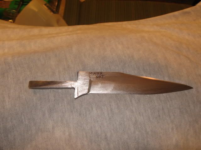

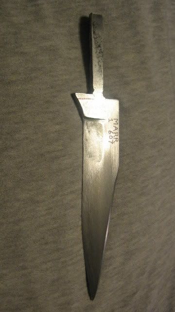

All right, made a little head way on the blade, but how do you all get those crisp grind lines on those blades. Here are some pics. after I polish it up and finish everything, I won't have any distict lines like I want.
Anyone?? I just put the bevels on the top. I can't seem to get the recaso sharp either, too rounded.
