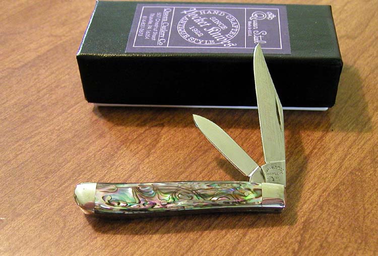

i was looking at this knife http://soonerstateknives.com/Q-14ABW.JPG
what do they use in those knives? it seems to be pretty big and thick pieces. is that some kind of glued together laminate kinda similar (when making it) to micarta or g10? or perhaps grinded down and mixed with epoxy to make a big peice? or is that a single natural peice from a shell?
i think i found my answer in your link.. its probably some kind of laminate.
my god they had some fine pieces on that site :eek:
so is this laminate still as dangerous to work with as natural shells?
