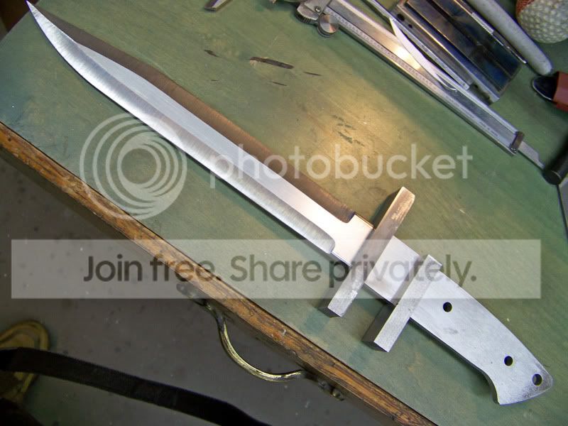

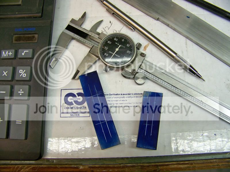

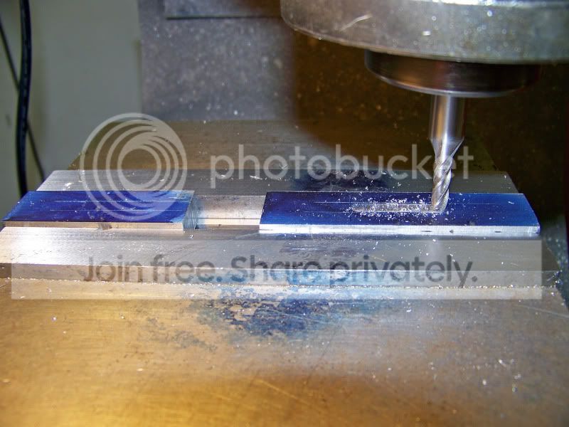

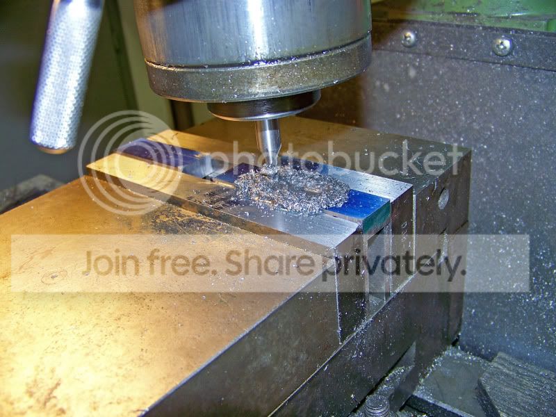

This is how I do it. I use layout fluid and scribe them out to exact size. Remember end mills can bread so only go a few thousands of a inch at first and then you can take out about ten thousands at a pass. I set the stops on my table so it stops at each end otherwise you will go farther each time and cut the slot too long and/or break the end mill. I use koolmist in a bottle to keep it from over heating. If it steams its too hot. Just go slow, theres no rushing this process.
When the slot is all the way through leave the end mill there (all the way through) and work on the sides back and forth until it is the correct width. The mill will cut really nice using the flutes. Its amazing how pretty the slot gets when you are cutting the sides.

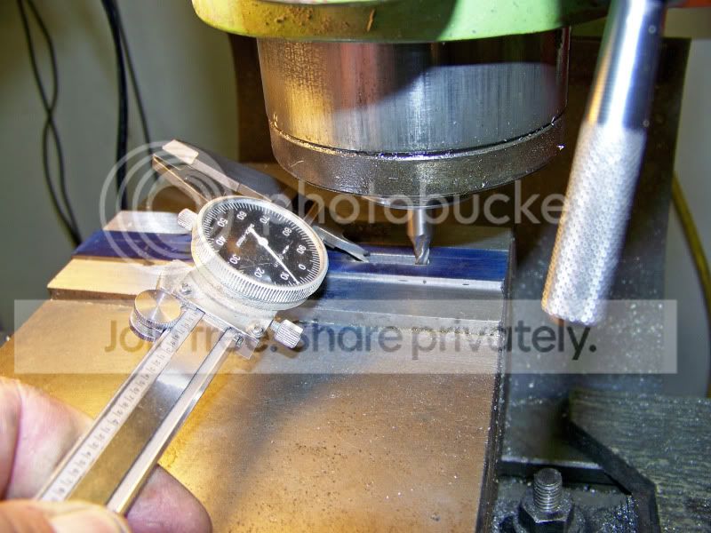

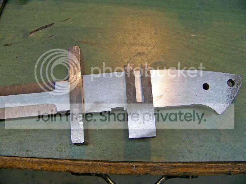

I measure the blade and measure the slot and can come within a thousandth or two. Maybe some hand file work to make a better fit or if you get the slot just a little too wide you can press the gap closed on the press.
Hope this helps somewhat.
I have no idea why this picture looks like the mill is at an angle, it is perfectly straight up and down. Optical illusion I think.
I have an entire WIP on this sub hilt over on knifedogs right now. Check it out at: http://knifedogs.com/showthread.php?t=1911
