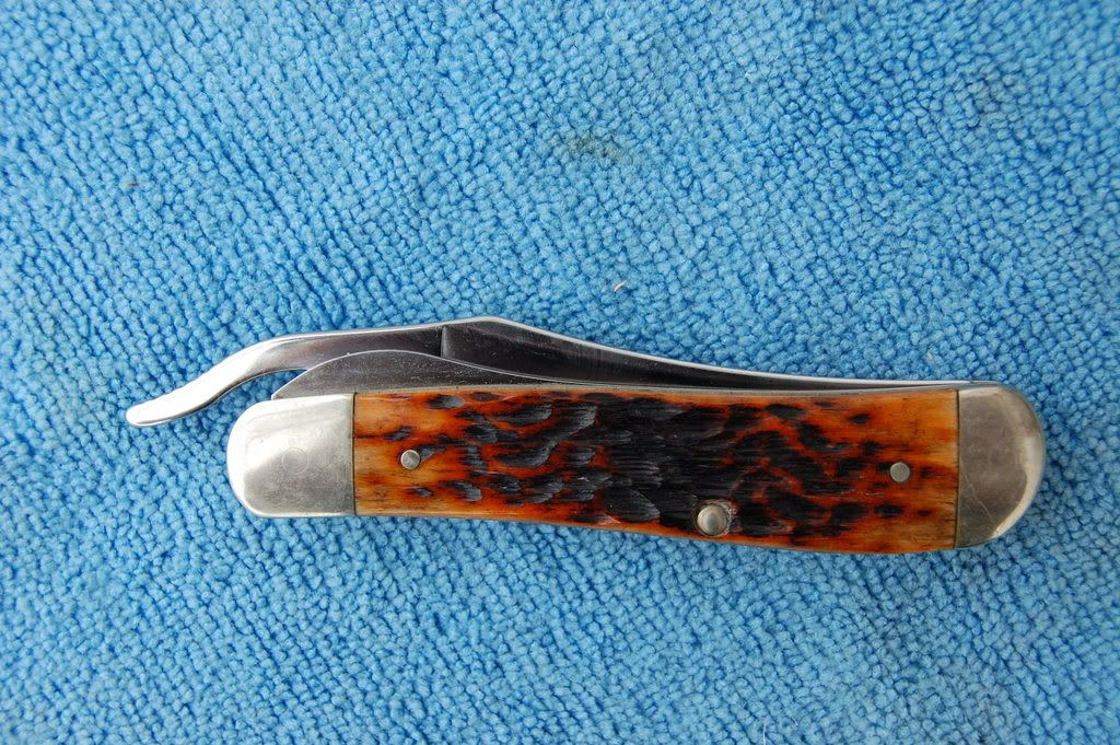

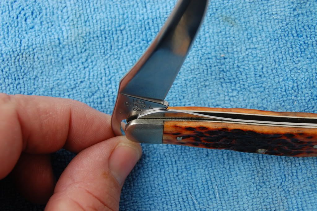

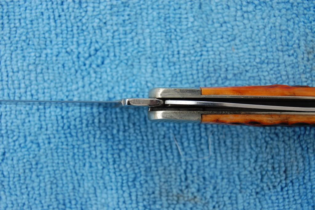

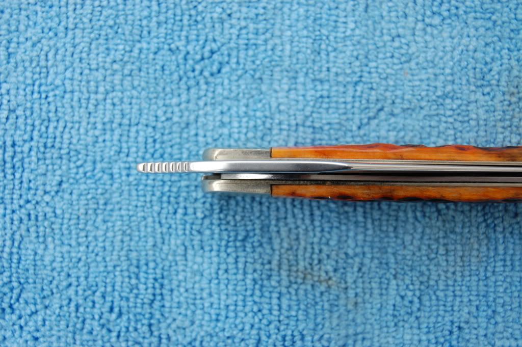

Yep, the tab you see is an opening lever. The lock is an old-fashioned liner lock. By that I mean the knife has a traditional slipjoint backspring to hold it open, the locking tab is strictly a second safety. Mine has a substantial amount of vertical play between where the backspring holds the blade and where the lock stops it when you try to close it.
It is the sort of knife that demands a slip cover or belt sheath, as the opening lever is a real pocket eater.
