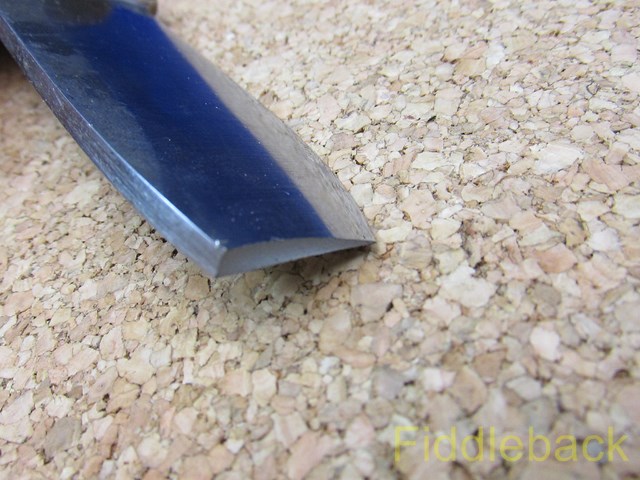

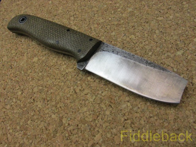

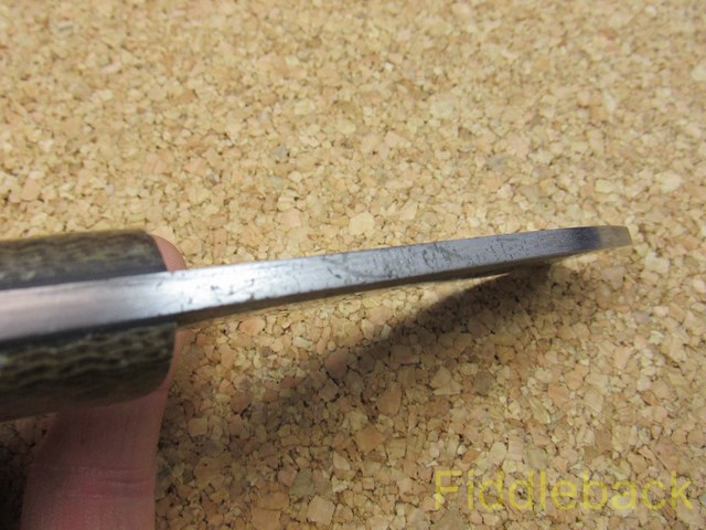

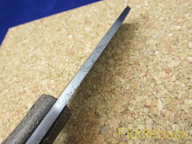

The bad news: I got a knife back this week with a broken tip. It was bought on the used market and the end user was batonning it correctly at the time of the break as far as I can tell. The spine of this knife has been beaten with a rock, and as it happens, one of the divots knocked into the steel by the rock created the stress riser that caused the break.
The good news: The grain looks great on this piece. The HT checks out great. There are no gaps between the handle scales and the steel. The knife is nice and sharp.
I am replacing this knife because I appreciated the end customer's honesty in this situation and I hate to see him out of luck because of someone elses buffoonery.

Ouch!! That's a nasty break. Thanks for the pictures. That grain structure does look good. What's going to happen to that knife? It looks as though there is still plenty of life left in it.
The grain does look good from what I can see.;)

All that needs is a "Carver" model tip regrind (drastic wharnie point) and a spine smooth and shine and it's good for another (hopefully more responsible) owner.
Yup - I was looking at that and thinking it's make a great sheepsfoot pattern at this point.

This isn't the first tie I've faced this guys. It is one of the reasons that I have begun chamfering my spines. The other is that quality knife connoisseurs demand it. But if that knife had a chamfered, rather than rounded spine, the divot that caused the break would not have hit a sharp edge, and possibly would not have caused the stress riser in the first place. Still stupid to hit a knife with a rock.
