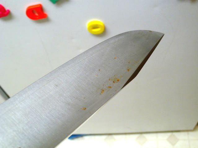

Also, this knife will develop surface rust if you do not dry off the moisture and especially saps from various grasses. It buffs right off but this type of rust will develop in a few hours. Keep 'er clean and no worries.
