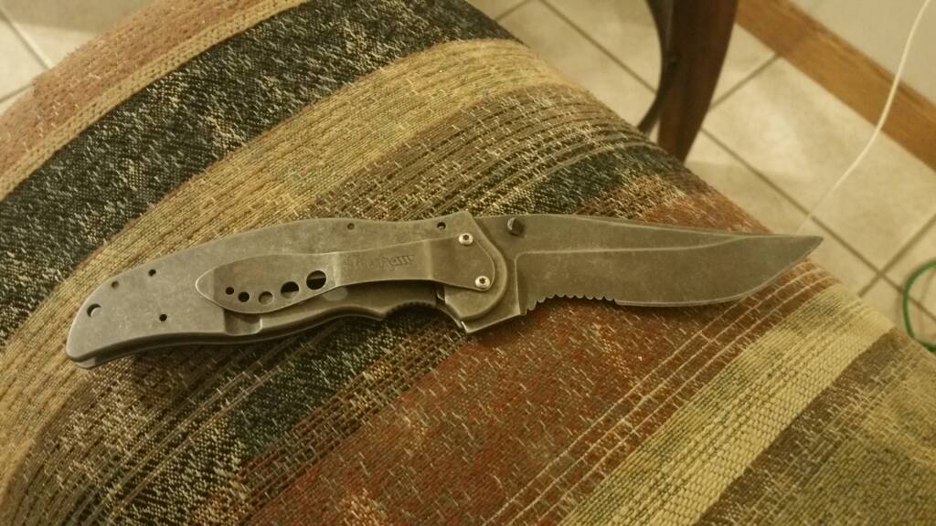

Also, not sure what you are planning to use to stonewash, but I got the large vibratory bowl from harbor freight for around $150. Here is a sample of a customers Kershaw that I did with the 3:1 ratio then tumbled in the bowl with ceramic media.
