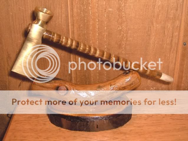

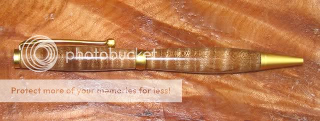

Using heat from a heat gun to oxidize the sugars works better with more consistant results. Some areas will darken more with using liquids but heat can be controlled more. If an area does over darken you can use 0000 steel wool to take off the layer and blend it in with the surrounding area.
Used a heat gun on these hawk handles.
Pen

Just heat and carding it with 0000 steel wool afterwards. Yes you can see the curl bands darken as you apply the heat. I use mostly tung oil and tru oil to finish curly maple.

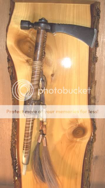

Matt Roberts(LongRifle),used muriatic acid on the maple handled boot knife he built for me.
I really like the results. :)

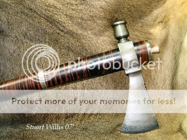

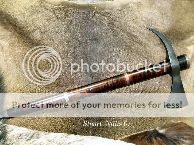

The mix that Butch is talking is:
3 parts water (About Pint Size Parts)
1 part muratic acid
ALWAYS ADD ACID TO WATER just remember 3A's DO ALL THIS OUTSIDE AND DON'T INHALE THE FUMES!!!!!!! WEAR EYE PROTECTION!!!!!
I then pull a pad of 0000 steel wool apart and add to the mixture. Let mixture dissolve the steel wool usually takes about 2 days. It is then ready for use.
The finer and slicker you get the wood the better the stripes will pop out. I apply sparingly. It will turn the wood a yellowish color. you will think you have ruin it. Apply heat with a heat gun or torch till blackened. Don't burn it just turn it black. Again you will think you ruined it and by this time you be hating me. Rinse with baking soda and water mix almost a paste but still a liquid as you wash it will turn brown. Steel wool again after drying and add you favorite finish.
Every piece of maple will be different try a small scrap piece before doing the actual piece. if it doesn't suit you you can always add a little leather dye to get more reds or browns.
This is an old muzzleloader builders recipe.
These where finished with this.
