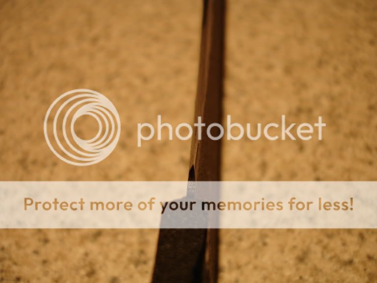

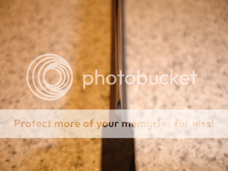

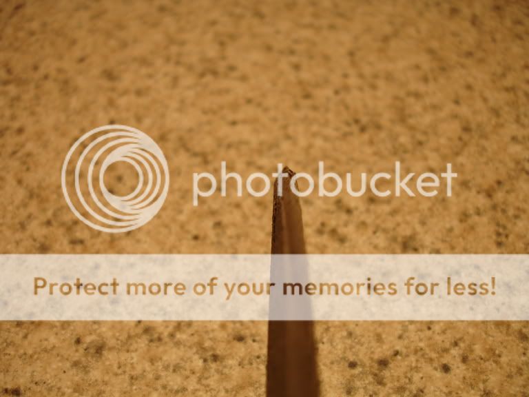

With all the talk about Camillus circling the drain, I figured now was as good a time as any to purchase the Becker BK1 Brute I had wanted for a long time, but never moved on. I received my BK1 yesterday. Everything was as I expected except the edge. It looks like it was ground at 6:23 pm on a Friday by an inexperienced member of the 'skeleton crew.' Take a look-see:
Chisle grind (almost), anyone? This is very atypical of the other Beckers that I own. I'm disappointed with the edge, but not discouraged. I'll touch it up the best I can and use it. I'm sure it will serve me well for a long time. Has anyone else noticed any 'variations' in their recently acquired Becker pieces?

Hikeeba, I have several Beckers including the Brute. Not all the grinds have been very accurate. I have had very good success using a mill file to fix the gross problems before going to stones. The steel on these is much softer than a file and it will cut very readily. That is one messed up grind line. I am betting it was an attack of some manager trying to do a skilled laborer's job.

I think you should send that Brute back to wherever it came from, and request a replacement that has been examined prior to shipment. You're going to have to remove a lot of material to get that edge even and at a decent angle, and the Brute is already so thick behind the edge that you don't want to get any higher into the grind than you have to, as the edge will take a lot of work, and the transition into the primary grind will be very steep.

Anyhoo, I'm not worried about it. I just thought I'd point it out, as I haven't had any edge grind faults on my other Beckers. My trusty mill bastard files will have it shaped up with a little elbow grease. I reprofiled the edge on my TacTool, just to make it a little more useful. If I remember correctly, working the TacTool didn't take too long. The BK1 is a larger knife with a little recurve to the blade, so it may take me a little longer. My next opportunity for 'knife fun in the outdoors' isn't until mid-September, so I have plenty of time.

I worked on it for a couple of hours and finally got an acceptable, if not pretty edge. And I do like the knife very much. From now on when buying online I'll insist that the seller inspect it before shipping. Probably a good idea to do that anyway.
