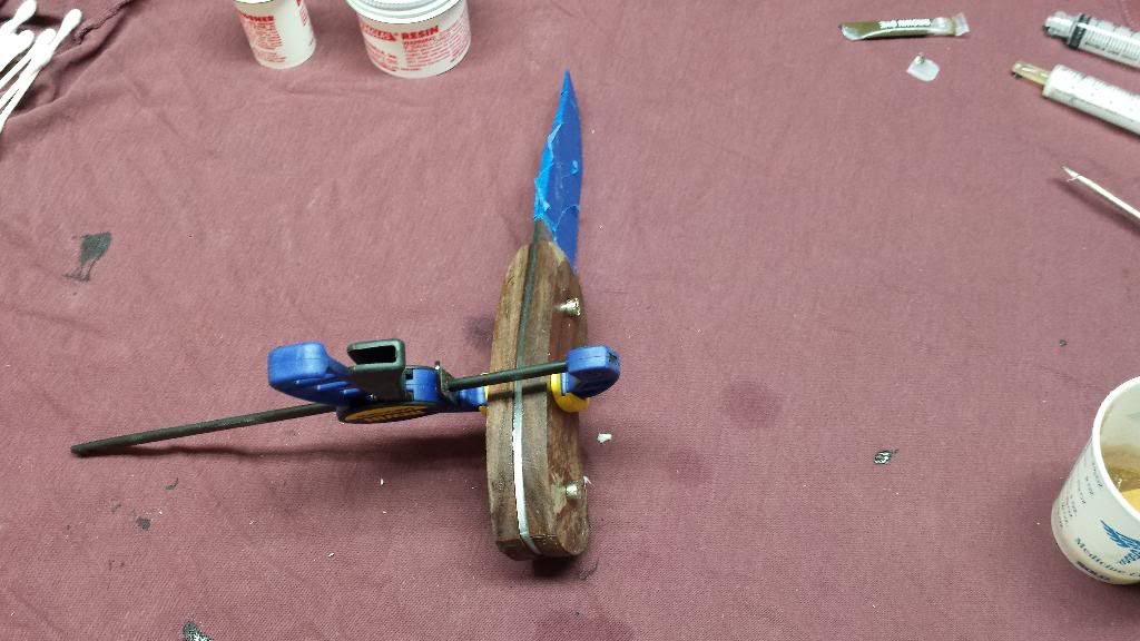

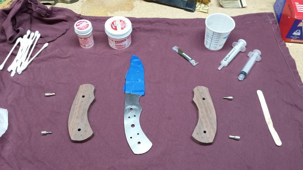

Well its a done deal now! I set a timer for mixing it was a long for minutes glad I timed it. I have to admit doing it for the first time was a bit nerve racking. I hope I did it all right :D I mixed up a lot more than I needed but didn't want to run out.
Thanks for the help everyone.

Looking great Droptine! My apologies for any confusion I may have caused. I will probably pick up some liquid, if it is considered tougher, I can definitely see its benefits on a "Hidden Tang". I will use every edge I can get.
Hope you continue to give us pics of your progress.
