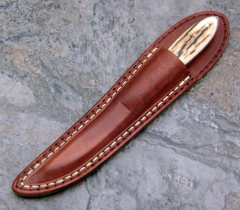

First time poster(here)...long time lurker. :D Here is something I discovered because I wanted to try something different. I'm sure there are better ways to finish leather, I'm just sharing the results of my experiment.

BTW, I did some more Googling and found lots of uses for Future Floor Shine/Wax, especially in the scale modeling world. Anyway, wanting to do a little experimenting, I headed off to Kroger to see if they had Future Floor Shine/Wax....they didn't...but they had Pledge with Future Shine which is a clear acrylic finish.

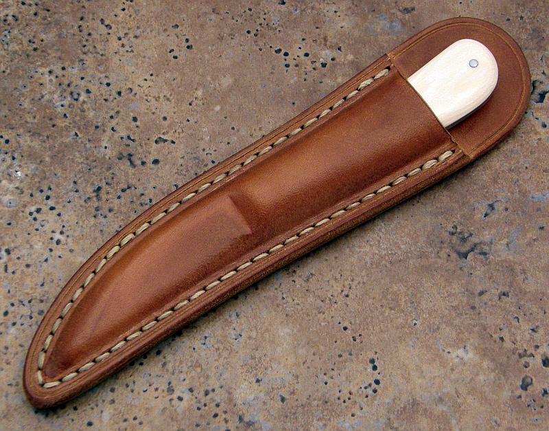

I tested it on a small piece of undyed leather by applying it with my finger over the top surface. It darkened the leather with somewhat of a redish tone but left a nice finish and seemed like it was thoroughly dry within about 30 minutes. I had one sheath that was previously dyed with Fiebings Saddle Tan Pro Oil Dye and thought, what the heck...I'll give it a shot. I can always make another sheath, RIGHT! :)

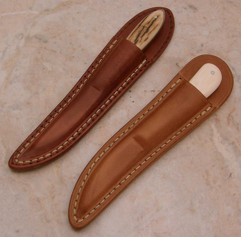

Here is the result. The finish was nice but it does make a completely different color; darker with a bit of a red. I'd call it a chestnut color. The first image is of both sheaths that were dyed with the same Fiebings dye and shown side by side for comparison. The lighter sheath is finished with one application of Lexol, allowed to dry, then finished with a coat of Ren. wax. That is usually how I finish my projects. I'm not always happy with the final product.

Thanks Paul...was hoping you might have some thoughts about it. I wasn't crazy about the significant color change that took place but as long as it can be taking into account and won't mess up a project, I figured what the heck.

Thank you for that information. I am going to try this stuff on a few select projects of my own and keep track of how they do over time. Right now they look good, but it's purely experimental and I wouldn't recommend using the stuff without a track record of success. If it turns out down the road that using this particular product in this way is a bad idea, I will report it here.

I was hoping that if someone thought that it's use might be questionable, they would say something. Thanks TF and Kiah...it'll get limited use and I will keep an eye on it.
Future floor wax is not good for the leather and will not last if any water gets on it. It bubbles and flakes as well as drying the leather prematurely.
