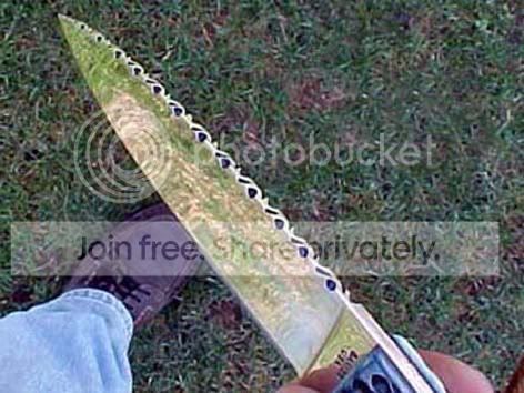

Personally I like the file work. Here is one of Rusty Prestons'
Jim
attachment.php
attachment.php
I think one of the very best places for file work is on the back of a pocket folder such as that pictured. Beautiful knife, Jim.

Here is one by WT Fuller, front lock, the file work is not cut as near as deep as the one by Rusty.
attachment.php
It seems to me that file work is either a great thing or NOT. Not much in between... Wonderful examples above.:thumbup:
I like looking at good filework on a well done knife. I despise poor filework on a poorly made knife.

I put filework on most of my knive because I believe that it enhances the over all appearance, it just something that I like doing. But not all of my knives have filework just on some series. I run a series of designs and add something unique about it. There is never a additional charge for the work it just a bonus on that knife. As a illustration here is one that I like, it reminds me of the crown that was placed on the head of Christ.:)
