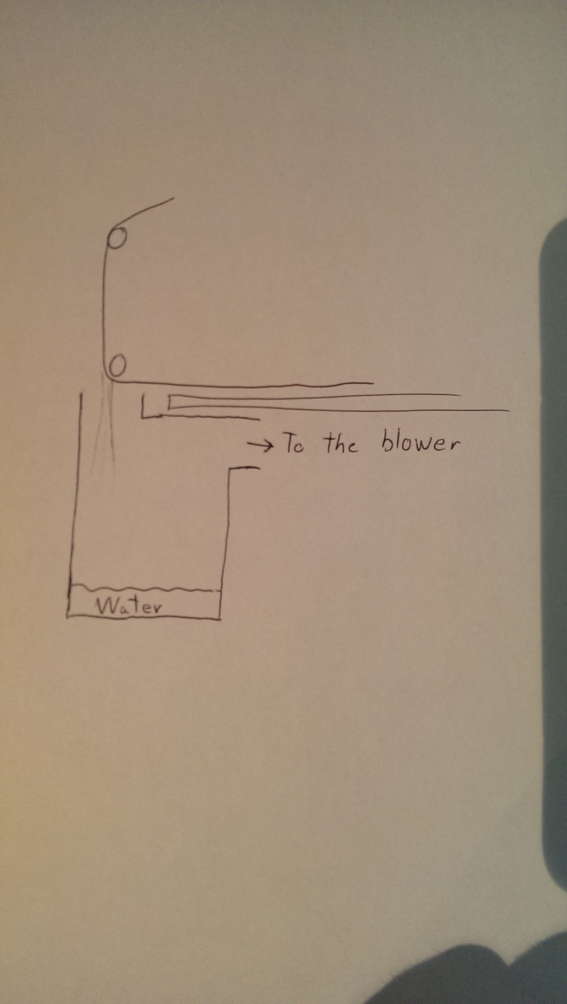

Would this set up be ok?

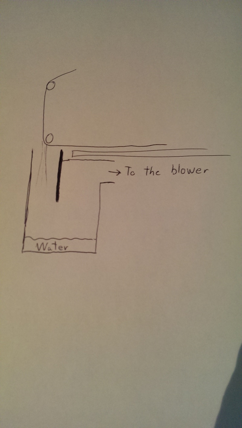

edit: it's not a 5 hp blower it's not powerful enough to make the spark curve and go directly to the blower.
It would work with a minor change.
The inlet needs to extend down to about 5-10cm above the water surface. That directs the airflow and sparks straight down toward the water.
As you have it drawn now, the air flow will just go sideways into the duct to the blower.
