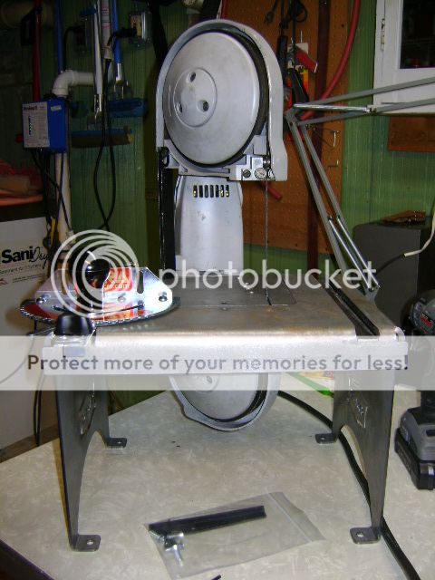

I have a Milwaukee Portaband saw that I'd like to ad a table to (my plumber wanted a new one so I got his old, perfectly maintained, one pretty cheap. I suppose I could spring for the Swag Offroad table but I think if I see what some of you have done with yours I can do this mod. I was thinking of using 3/16 -1/4" aluminum for this. I'm also curious how big I should make this?
So if you have any pics of your saw I'd like to see some. Particularly if you wound up drilling and tapping holes in it.
