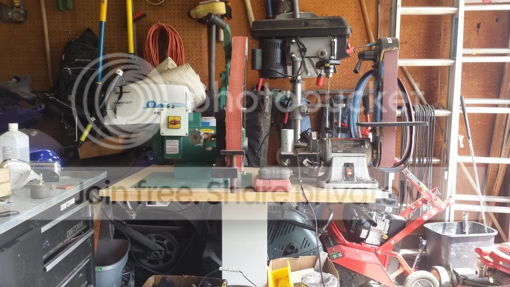

Well, I bought a bader bII last weekend for a great price and got to thinking...

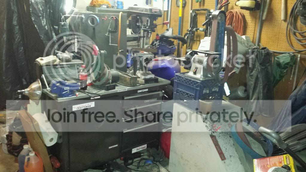

I need a new work bench for this beast!! I've been grinding on a 2x42 zip tied to a milk crate which was strapped to an old corner tv stand. Not even close to ideal height or stability...

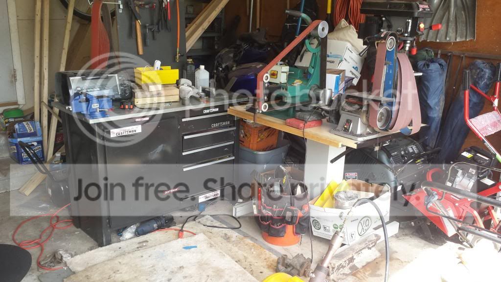

I have back and knee problems and instantly started looking for ways to make an adjustable height table. That way I could easily switch from the seated to standing positions without too much effort and effectively get more time in the shop. Naturally the bolt together height tables didn't appeal to me as I wanted relatively quick adjustment, so I hit google. I ended up finding an older video of a man who used an electric drafting table for his wood carving projects. It has a locking lever for tilt adjustment and an electric motor that takes the tabletop from 30 inches to 48 inches tall.
I hit craigslist and scored one for $175. I intend on removing the tilt mechanism as it's not quite sturdy enough for an application like I intend, but the top can easily be hard mounted to the base. I have the bII, a 2x42 craftsman, and a bench top drill press on it. The motor seems to have no problem lifting that weight up.
This is a link to the exact table I purchased, just got it without the drafting system on it:
http://www.ebay.com/itm/Mayline-Pow...061?pt=LH_DefaultDomain_0&hash=item27e4a2a1dd
Quite a sturdy and heavy base to work with and only takes about 40 seconds from full up to full down.
Just thought I would share this as it was somewhat of a revelation moment for me. Seems they pop up every so often and can be had for a decent price especially given the retail in the $2000 range...

I've never been a fan of the bar stool route because of the way you have to plant your legs on the stool itself. That means your legs don't move or aren't in a comfortable position and can press into the nerves in your butt/thighs. I find the most comfortable way to sit is with my feet planted flat on the ground so I can adjust my knees to different angles as they stiffen up(and keeps the back straighter).
I tend to do things in batches and grind for hours at a time. I have no problem going all out for comfort and ergonomics, and the price I paid was by no means all out. I definitely see what your saying though, this is a bit overkill for most people! :D

Honestly, I had the plans laid out for exactly what your describing, and you can even see all the 2x4s in the background. I just always hated sitting so high up with only one spot for my legs to go. I was determined to find a way to make the best of both worlds work. I'll be using that wood to make a couple shallow shelves around the base now.
Like I said, way overkill and agreeably overthought. But I must say my back is already thanking me! Still trying to get used to grinding sitting down, but it's only a minor adjustment.
