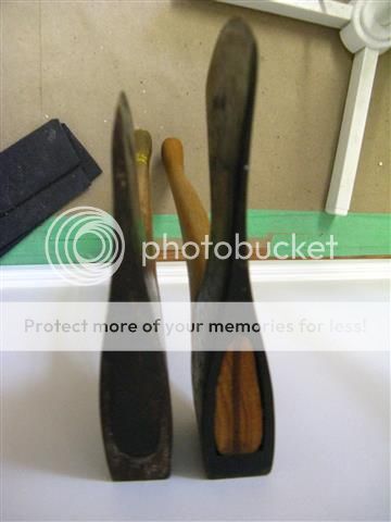

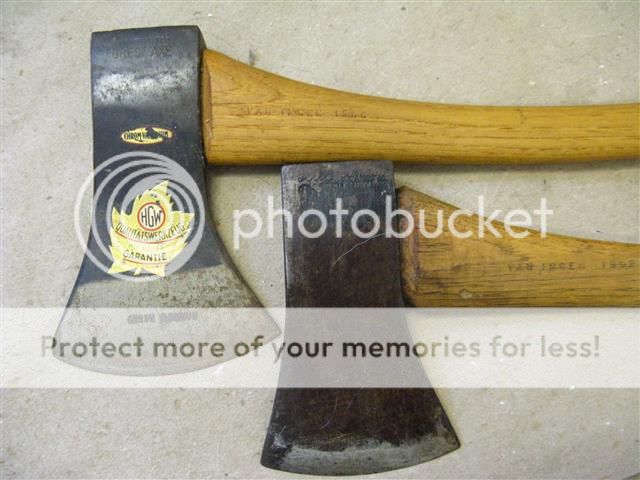

North American folks on here generally diss the European axes for lack of convex cheeks and for having overly pronounced blades and here are two of mine. The 1950s-made "Ha-Ga-We (HGW)" forest axe from Austria features exquisite steel (which rings like crystal!) but the blade is scary oversize and too thin for me (hence I've never used it enough to even wear off the decals) whereas the 1980s West German "Oxhead Iltis Canadian" has been a favourite of mine for almost 25 years.

Me neither! For chopping and limbing Euros literally are the cat's 'posterior' but when it comes to splitting you specifically don't set yourself up to inadvertently bury one anywhere in a large piece of wood. But if you look at the HGW I posted up earlier there is way too much blade out there for the weight of the head. I could never get comfortable swinging that thing, likely because I am long-time used to more conventional shapes and much more modest blades.

Bingo. I find the really thin-bitted axes have a higher ability to one-hit stuff and once you've opened the cut on a larger piece of wood you don't really see much binding because there's less wood to one side of the bit to do any pinching. I also find the thin bits to benefit from a "lazy" swing to ensure you don't over-penetrate, particularly on those opening blows. Definitely less of a "one axe" solution, though.
