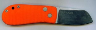

I don't know anything about this little knife except that my wife thinks its just yummy! :D

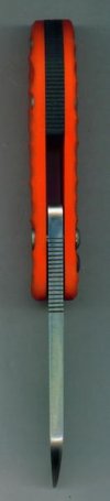

Its probably one of the better friction folders I've handled. Blade is .160 plus thick and has some neatly done jimping and the spacer has that same pattern on what looks to be some kind of black G10. The orange G10 scales are hand grooved to give it some artsy appeal and overall its quite attractive. Blade length is a mere 2 and 3/16" and the whole thing opened looks to be 5 and 5/16".
Anyway its here for a pocket clip. A low rider is what is being ordered for tip down carry RH so I've got to be doing some homework here to figure how to weave a mounting area for the clip between the two barrels and screws there. Then in the end once I get that part mapped out I'll have to show that to the owner and get his ok or ideas and once we are past that I'll mount it using some stainless steel threaded inserts installed in the underside of the folder scales to give some good bite and retention.

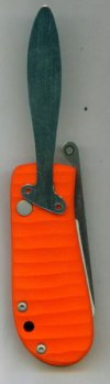

Ok seriousl. Here is a proto type clip to sample for the owner. Now keep in mind this is way long, way wide and thick a bit yet but the mount position is what I was trying to come up with. This is probably as good as you are going to get for where to put it. Now to shape the clip and shorten it because its obviously going to be a bit long when folded over. However if you visualize it same shape thinner and shorter we can get an idea of what I have in mind. I can thin it as much as you want though.
Its really tougher to figure out than it looks making one of these from scratch, which makes it good thing I don't really charge by the hour on these one time deal projects like this.

Not bad at all really. It really needs some liners with some Emerson detent cuts in them to give it some retention against gravity though. Thats what I'd do personally. Cut em out different so they are not exactly like that but would do the job even if they are horizontal instead of angled vertically or something and make them wider or something. Even if it had one of those like the Emerson knives have on the non lock side it would be a lot safer to carry, especially with a clip on it. Just my opinion though.

Looks great Steve, I believe we have a winner on the clip design, I'm perfectly happy with the way it looks! Anyways, i sent you an email about the detent, we'll see how it goes! Thanks for everything! :D
