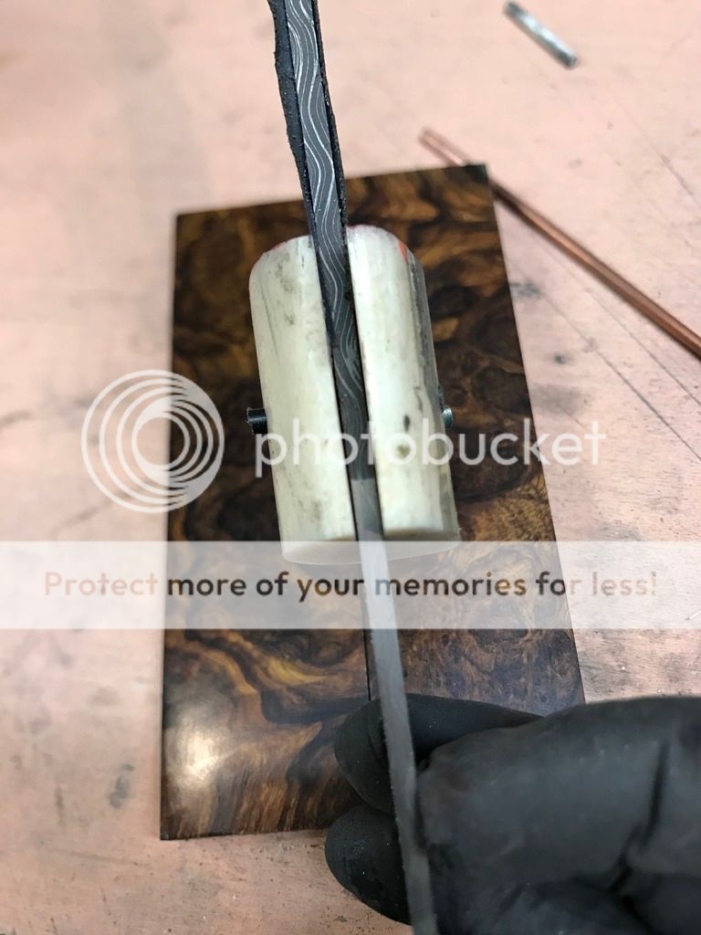

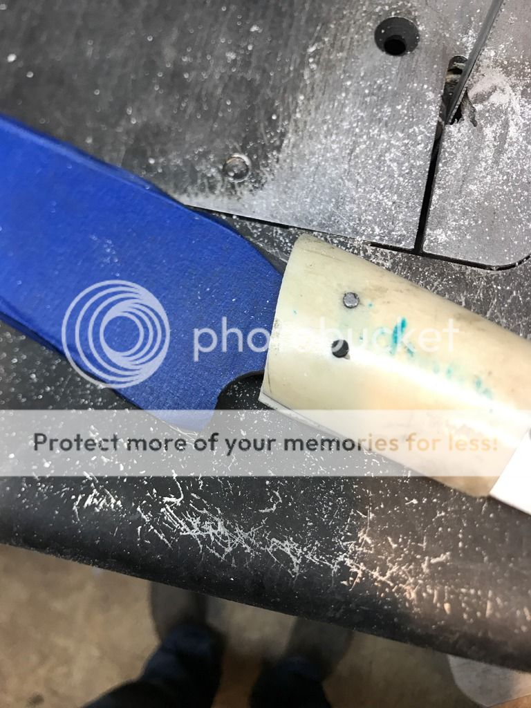

Thanks for the advice. It worked well to CA glue it to a piece of micarta longer than the walrus tusk then place another piece of micarta just thicker than the walrus tusk behind it to lay the blade on to serve as the template. I don't know if I described it well. I should have taken pics of the process. It wasn't as bad I was expecting. Here are some post drilling pics.
