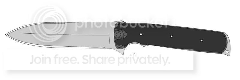

Hey there guys,
I've just whipped something up over the last couple of days, and I wanted to get your opinion on how it looked. It's my first decent try, be nice! :p
I designed this as a fighter/bush/utility knife. my concern is that I don't know what steel I want to have it as, maybe a tool steel? however, I live near the sea, and so there'd be a chance that it'd see some action there, so maybe something with a little corrosion resistance? I plan on having a full tang, but I'm not sure about whether I'd have it skeletonised or not.
my second concern is that the sub-hilt will present issues when changing grips, from hammer to a fencers to a ice pick.
finally, what do you think? oh, and what should I do about the handle material?
I'm hoping to keep the design for a while and then hopefully, if i am ever rolling in cash, get it made up. Preferably here, but second choice is definitely one of the US bladesmiths here ;)
I know this sounds paranoid, and I know you're a good mob of people, but please respect my ownership of the designs.
thanks in advance!
-Miasma.
D2 for a steel? Best steel that I could think of off hand. I'm not too sure about the super stainless steels.
No offense but I've seen at least dozens of similar designs so I wouldn't worry about theft. I'd drop the handle somewhat to make it more comfortable if swung or used in a chopping motion. I'd pull the tip down somewhat to give the user more control.
I really think if you lengthened the blade and gave it recurve and some curves in the handle it'd be dead sexy.
Course I'm just a good ole boy so take it with a grain of salt.
Edited to add:
Get rid of the multiple small pins, go with big corbys or flared tubing.
all points taken. by drop you mean shorten, right? I have biig hands, man. :p

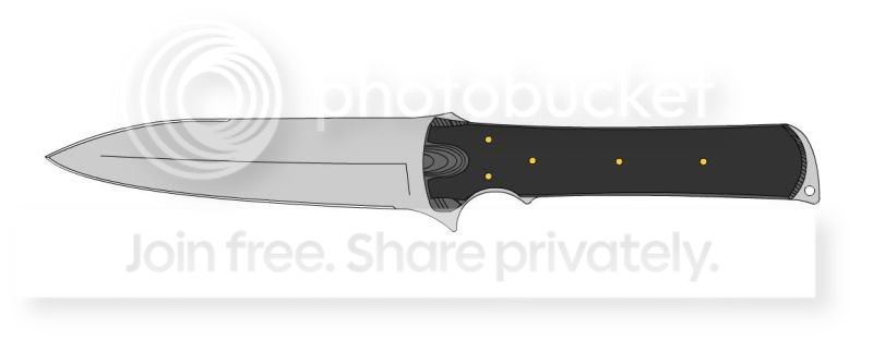

alright,
took some more things into account.
Changed the pins to flared tubing, and made the handle slightly more curved and ergonomic. gave the blade a liiittle more belly on both sides, and brought the sharpened back, back a little bit.
I'm not as keen to alter the blade shape. not because it's a bad idea, but because i find it more asthetically pleasing the way it is. keep the advise coming, though!
Munky, I'm all for micarta handles.
Keith, I hear great things about both 154CM and S30V, but apparently S30V chips? and 154CM needs sharpening quite often.
thanks and please point out more!

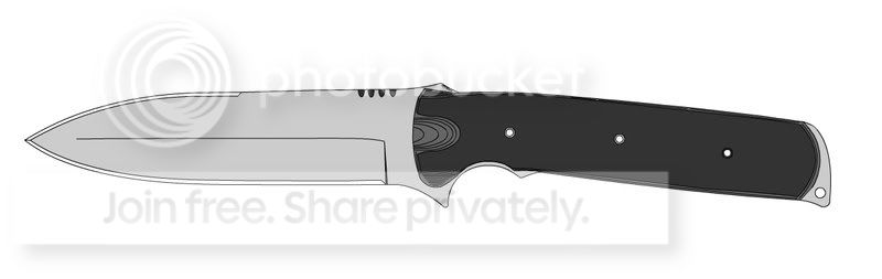

Ah, I actually hate the drawing tools in flash and always use photoshop for doing drawings when animating. So nevermind that. The changes you made weren't exactly what i meant, my fault on describing. Although the changes you made were still an improvement. I'll just draw over yours in transparent red to show you what i meant. you do what you want with it. What exactly are you planning on using this knife for though? Is it just to be pretty? or are you planning on using it? because fighting knives and utility knifes don't mix like clockwork, you need to make some exceptions if you want to make it more useful for utility.
I made a larger knife out of s30v, its not done yet but i'll let you know how it turns out. http://www.bladeforums.com/forums/showthread.php?t=594483&page=2 can be seen bottom of the page there. Not many people use it yet so there isn't a ton of wisdom around it. However from what I've read it gets micro chips along the cutting edge instead of dulling like a normal knife, this gives it micro serrations. In short, good for cutting and slicing, not great for push cutting. Im not sure what you would be push cutting with a knife like that anyways. The chipping mostly occurs on knives that have a harder tempering too, which wont be yours.
And cpm154 Holds an edge better than D2, so don't worry about that. But how are you making this?
Edit: Here we go. Not to take the fun out of designing your own, so this is roughly done just to show you what i meant
I'm just trying to give you an idea of what i meant, that blade isn't done perfectly either. Play with belly; Belly is the amount of a beer gut a knifes curve has. By rotating the handle like that (maybe no so much, play with this too) you protect your knuckles, and better geo for chopping. For the handle I suggest you play with clay for awhile using what you have so far and figure out whats comfy for you.

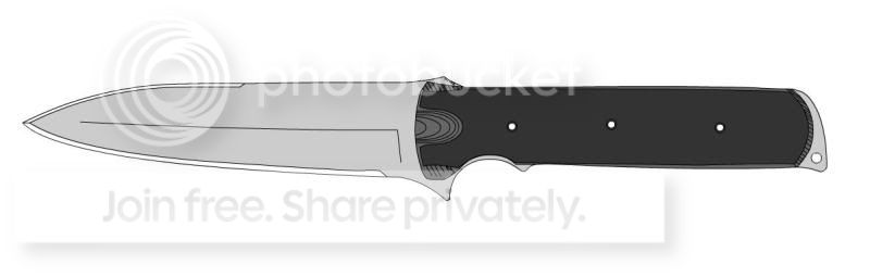

once again, tweaked the design, just a bit more detail now:
also, a few more Questions. is there a way that I could make the scales removable for a full cleaning of the blade and steel? what would you say is the best diameter for the lanyard hole, assuming I use paracord?
