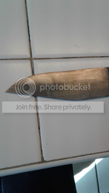

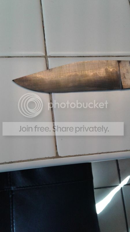

This is my first successful san mai blade. I am very happy I got it to weld successfully, no voids or delams at all.
The problem is my forging is pretty sketchy and there were deep spots and high spots and I ended up with some mild steel on one side of the tip.
The tip is pretty much where it needs to be so I can't just take more off that side.
This is at 220 belt finish etched for the sake of pictures. I hope you can see in the pics what I mean.
The good side.
Problem side.
I don't want to grind the tip off and I'm not sure I wouldn't have the same problem if I did. Only in one side like this how much will it effect performance? I planned to give this to a friend but if it's not going to perform then I will just junk it.
Pre grinding the core was dead straight, so grinding out flaws I must have (drifted?) to one side.
to me it looks like there is too much decarb and rough surface to judge what is actually there. you could shine up the spine and give it an etch to tell where the center core actually goes.
Not decarb, I left it pretty thick for ht probably took a 16th off each side.
I took your advice and cleaned up the spine and etched, spent about 10 minutes trying to take a picture and gave up.
I can clearly see the core and that is nearly all that's left. The mild steel is very thin and I can see where it stops at so thanks that was good advice.
I think I can get past the mild steel at the tip, it's going to be VERY thin but I think I can work it out.
