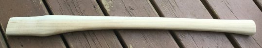

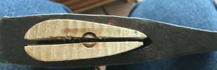

I just got a Sater Banko 2 3/4 lb head to refurbish. I was trying it out on some of the handles I have. Of all of them it best fit this 28” straight handle that I got from HH. It was one of their standard handles; not hand picked. The axe head slid on there like they were made for each other. With a couple of mallet whacks and a wedge, it’ll be done. The only problem is the grain on the handle is exactly at right angles to what it should be. I have no experience with this kind of grain alignment, but the physics and everything I’ve read say it’s not ideal.
Would you take a pass on this handle or give it a go?

/that will work just fine

I would give it a go!
I think that the 2 3/4 Sater Banko on a 28" straight haft would make a great "fallers axe" for trail work, especially when accompanying a crosscut saw......
In my experience so far grain orientation such as your handle has performed the same as perfectly orientated ones. I've found them to be a little more flexible. I don't think that's advantageous because it'll absorb energy that should be expended in the cut. I of course prefer the inline orientation but it doesn't really matter as far as I can tell.
Hang it and share!
I guess I'm in the minority here. But I wouldn't buy that handle, and I certainly wouldn't put it on any tool I expected to do any work with.
