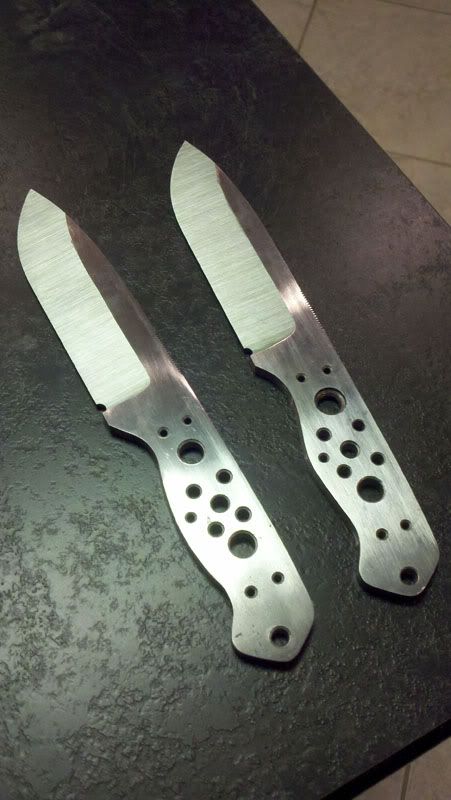

Well, got to the point where I was drilling holes in the tang of my first set of knives last night and decided to try chamfering the holes. I tried a chamfering bit, but the steel I'm using is 1095 and it ate the bit for supper. I also tried using larger drill bits and while that kind of worked, the holes were not round at all. Just curious if there was a recommended bit out there or a better technique?

Assuming the steel is annealed, you can just use a good sharp pocketknife or shop-knife to knock off the very corners. You can also "chuck" a counter-sink into a tap handle or similar and do it by hand instead of using the drill press (I'm told that far less speed and pressure = less likelihood of chewing up the bit). I don't think the chamfer needs to be very pronounced, just enough to remove any burr and help prevent a stress-riser.

Thanks, sounds like I was going about it the hard way. I appreciate it.
Don't worry about the uneven edges left by a larger bit, the holes don't show anyway :)
A carbide ball burr or round nose milling bit works very well, too.

Thanks, I'll check those out. This pic is from last night, I just went with a bit that was 1/16" larger than the holes I was drilling... seemed to work out okay.

I use cheap Ryobi chamfer bits from Home Depot, they work great and are under $10.
When I was starting out in knifemaking I ran through bits like crazy, now I don't even remember when I bought some last. Slow speed is key and practice is the most important thing in extending bit life.

Like Daniel, I use the Ryobi bits from Home Depot for most stuff. I have a couple of pricey cobalt single flute bits though that I like to use on stuff that will show, like handle tubes or exposed holes, just because the cobalt cuts really clean and smooth.
When countersinking holes, I use a 1-2-3 block on top of my drill press table so that I have the blade laying on something perfectly flat while leaving enough space for me to get a frim grip on the blade. Take the time to make sure the blade is laying nice and flat and you have a better chance of getting good smooth contact without chatter when the bit hits the steel.

Too funny! I smoked a 1/2" bit the other night, you're right about taking it slow. By the way, I've enjoyed and learned much from watching your Youtube videos... good stuff!

Okay, I've seen the 1-2-3 blocks online and that makes sense. I was drilling these out over a piece of 2"x4". Thanks.
