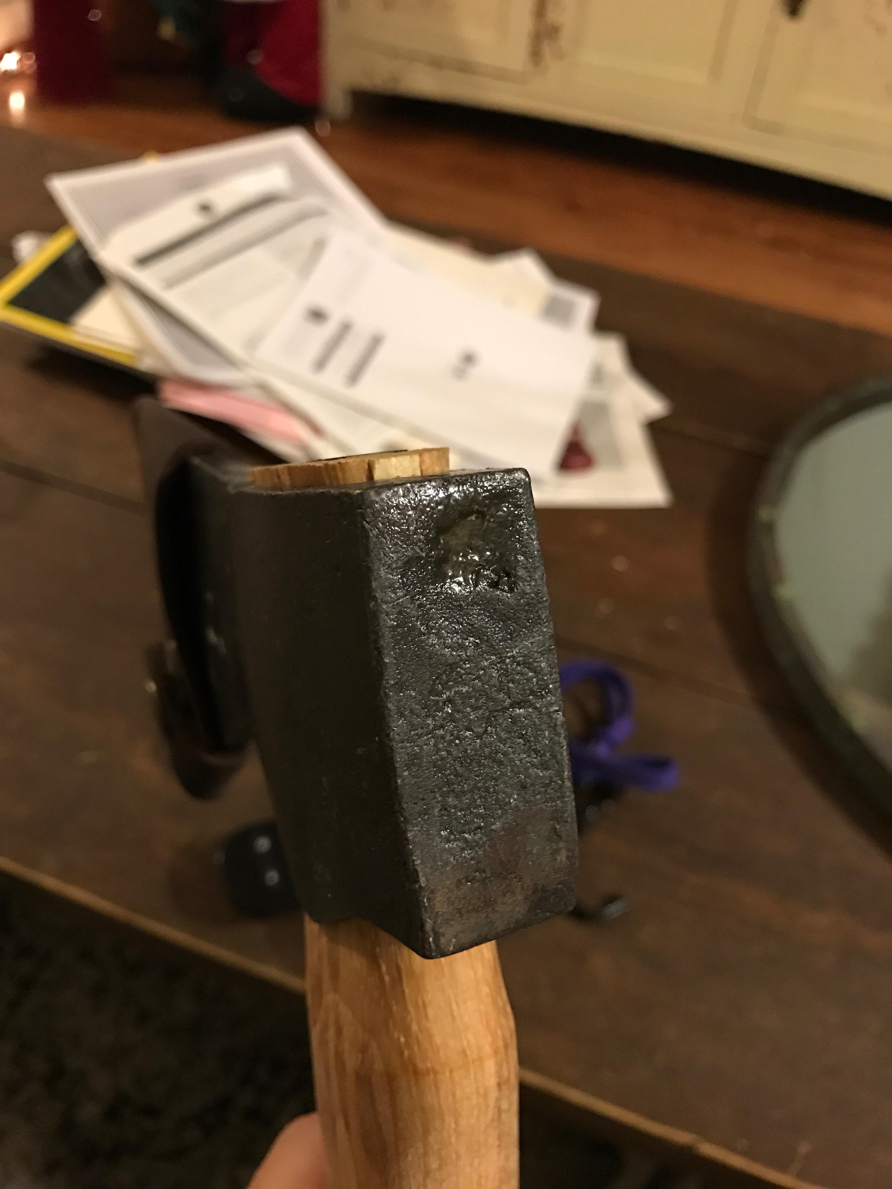

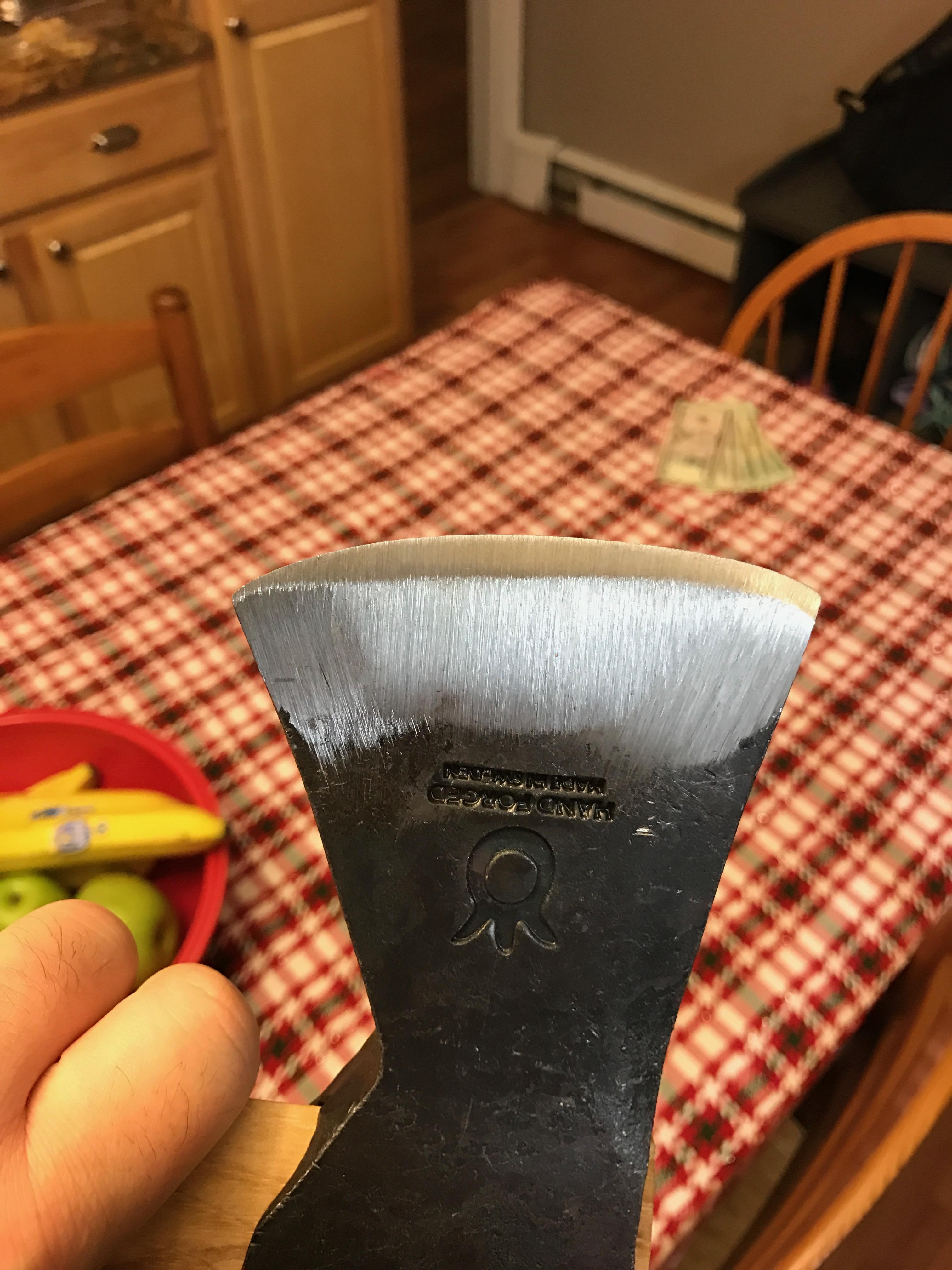

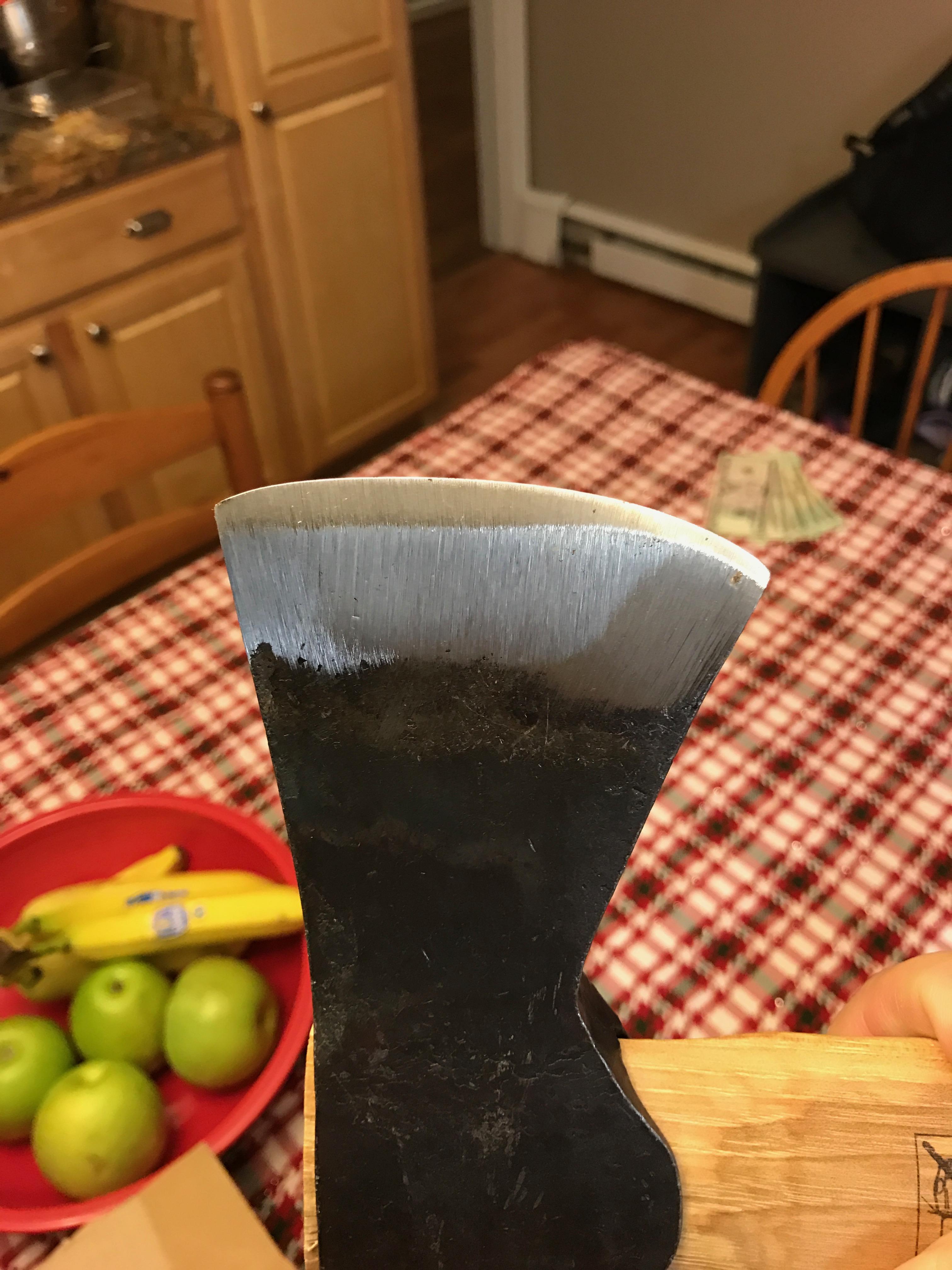

Thanks very much for the advice and replies. When I went back and looked at the bevel last night I can see that I had it a little backwards. But you can see the difference in these pics. Also, unrelated to the bevel, I noticed that there is some sort of epoxy on the back of the head, filling in what looks like a gouge. Is that something to worry about (first pic below).

The bit looks like it can easily be fixed with a proper file, the gouge in the poll could be filled with weld if you were ever so inclined but even as is it wouldn't' bother me.
Let's see a view from the end or the front, namely an edge profile. What we're looking at so far is a side view of brutish belt sander smoothing. Unless it really bugs you the dimple in the poll is going to stay; you're not supposed to use that end of the tool as a hammer anyway.
The gouge in the poll bothers me. The bit is easy to file.
I'm not sure that poll would cause me much concern do to it not being a striking surface anyway. The grind is easily addresed with a file if it bothers you it didn't look terribly out of whack from the photo angles you posted imo. I'm not sure the husky's are seconds they maybe but at the price point they are selling them at I'm sure they are spending a bare minimum of time on fit and finish.
Of course it's a striking surface. Most felling wedges are now plastic but there are also aluminum wedges available. Wooden glutes may be struck in bushcraft work. Plus there are wooden pegs and stakes to drive. All sorts of uses for the soft poll of an axe.
