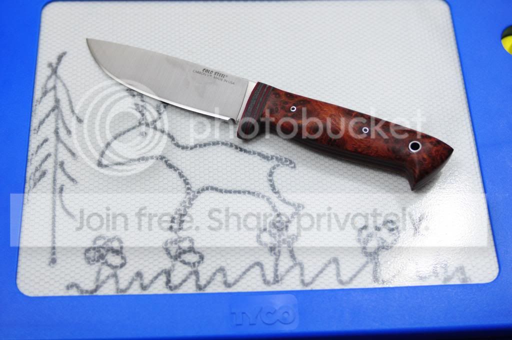

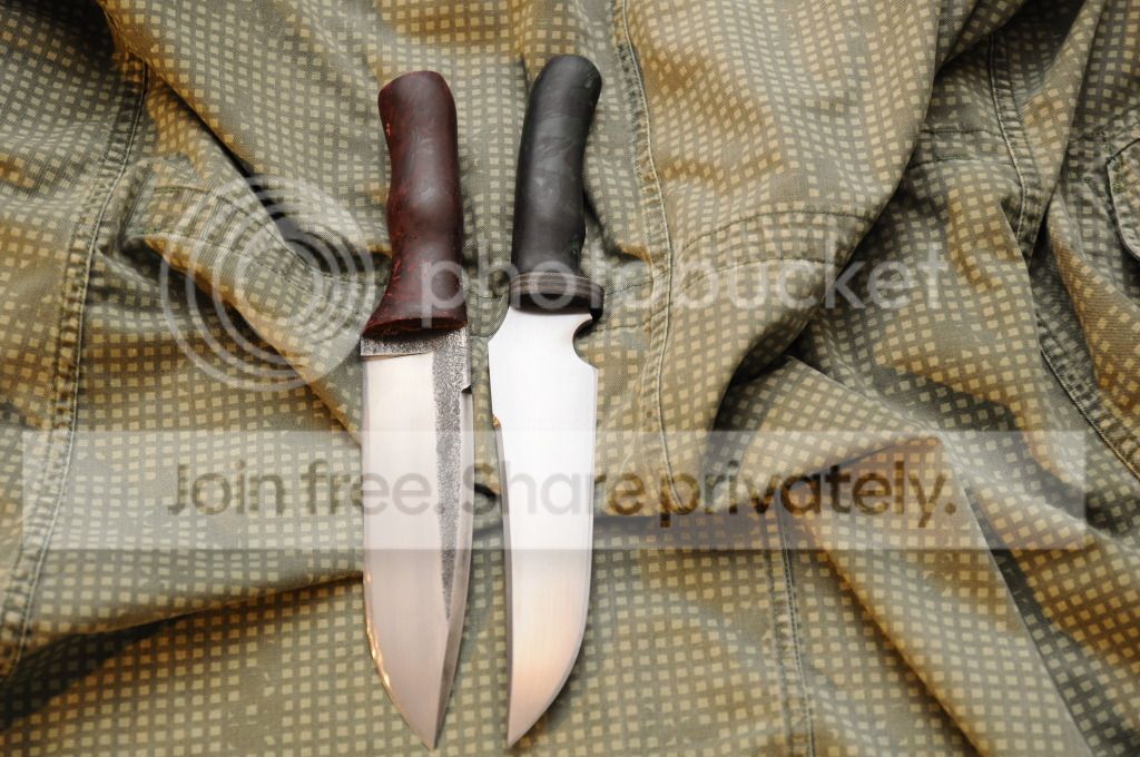

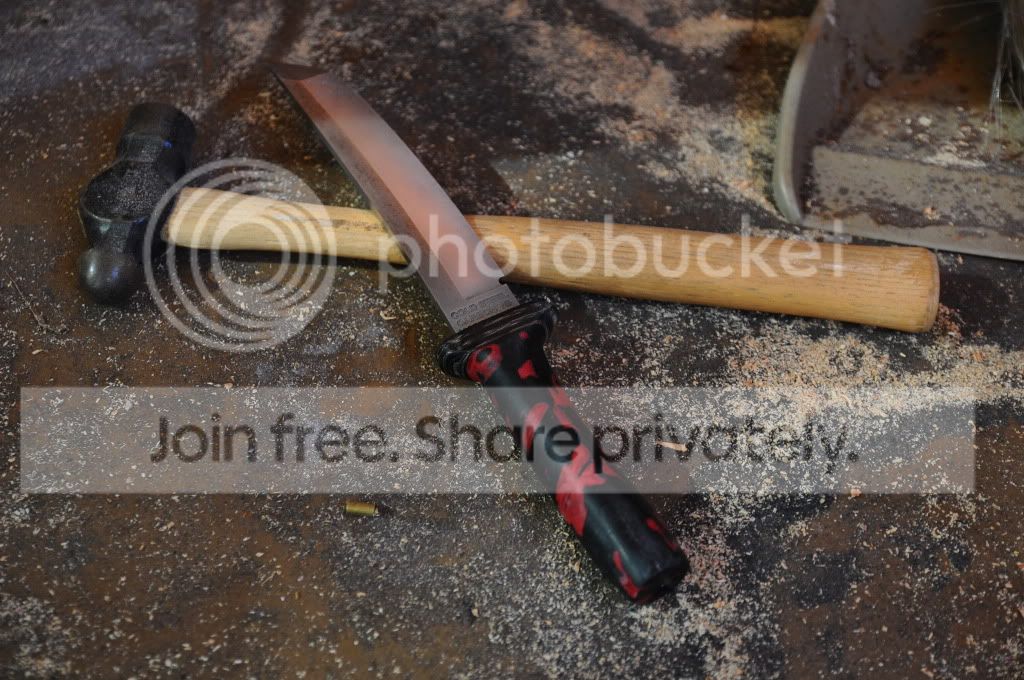

I've been doing alot of wrapping lately. I'm no expert knife maker but one thing that makes it come out much better looking is putting on a bolster or guard before wrapping and then tape up the rest of the blade. I generally make my guards from homemade micarta because I lack the skill and resources to do brass or steel right now; slot them, then epoxy in place. Once the epoxy is set on the guard begin the wrapping process. I don't have tutorial pics but below are some finished pieces made from Cold Steel knives
Using the factory guard:
I like to work in about three phases. First layer is only a few wraps. Let cure, dremel out any resin pockets, sand it well so the next layers adhere. Repeat the process until the handle is two or three times bigger than what the finished handle will look like (I make my micarta guards two to three times bigger as well). Sanding between phases is important otherwise your successive layers won't stick well and in some cases just come apart.
To compress each phase, I use regular saran wrap. Wrap it very tightly from bolster/guard toward rear of the handle. Then wrap very tightly with masking tape. Put the whole thing in a plastic bag and submerge in warm water (will cure faster). Peel off the saran wrap after about an hour, it comes off easier while the handle is mostly cured to a hard stage but not fully cured.
Hope this helps somewhat.

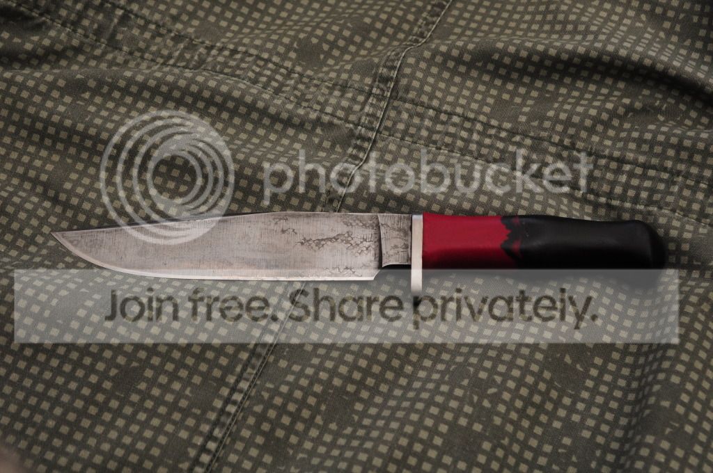

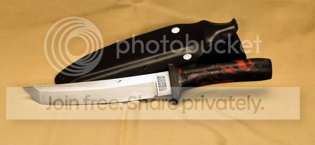

ETA: if you don't want to do a bolster or guard then you need an oversized slotted block of wood that slips over the ricasso area secured with a clamp. Put a layer of plastic wrap over it so your micarta doesn't stick to it. You'll have to find a way to keep resin either from seeping up under the block or removing the block if it does. Sometimes I use cooking oil and a q-tip and apply it to areas likely to be a problem, just be really careful not to get the oil on anything else. This will give you a flat surface for your micarta to butt up against as you're wrapping it. When the resin cures remove the block and shape your handle. The red one in the pic below is an example of this method

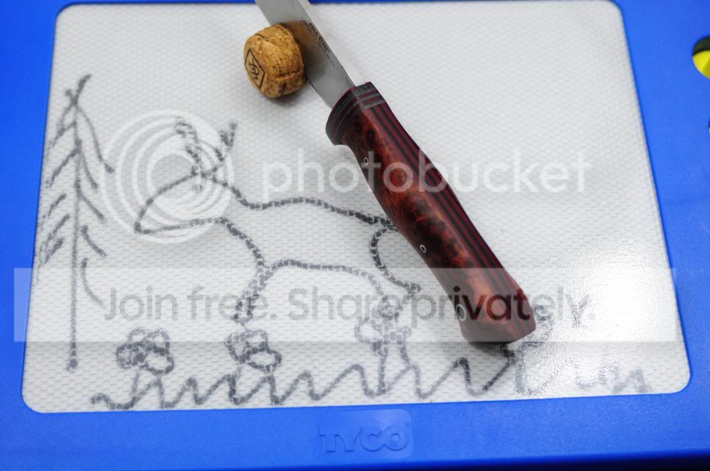

Here's another project that might give you some ideas.
Homemade micarta bolster and liners with stabilized wood:
