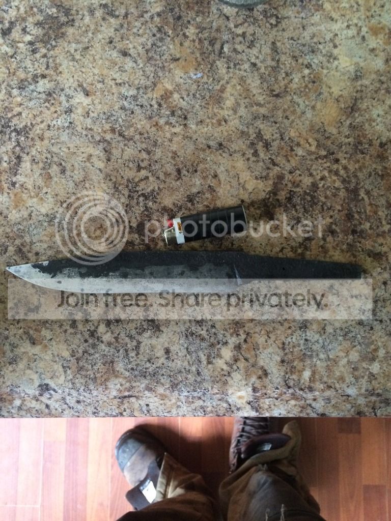

Ok, let's try to link some pics in Here
URL=http://s1180.photobucket.com/user/Grenfellsbrutalforge/media/Mobile%20Uploads/image_zps53oppsnh.jpeg.html]
[/URL]
If this worked, it is a picture of the 17" oal Bowie I spoke of. This is the first knife I made, the one that started it all

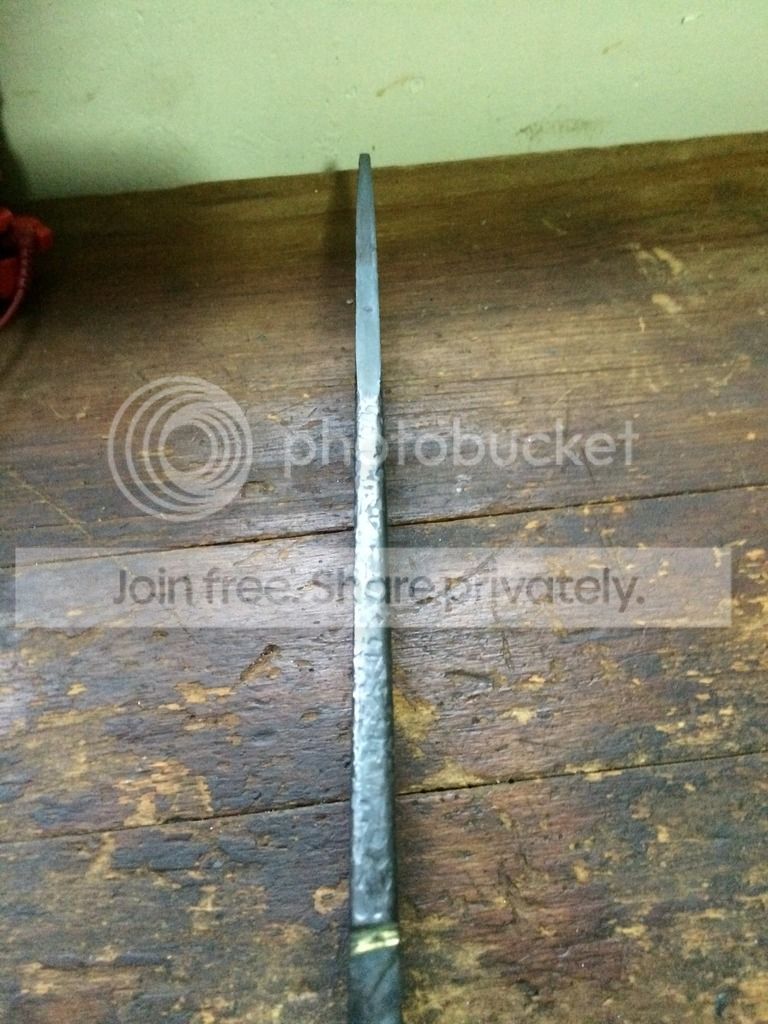

And now the knife that this post was started about.
URL=http://s1180.photobucket.com/user/Grenfellsbrutalforge/media/Mobile%20Uploads/image_zpso9cxx852.jpeg.html]
[/URL]
Did the final forging on it yesterday, and cleaned up the profile with the angle grinder this morning. The edge has been painted so it can be marked and the bevels be filed closer to shape then hand sanded a bit and then heat treat.
Turned out 9" blade, 4.5" tang, spine is 5/16" at ricasso, tapering to 3/16" about 1" before the tip. Widest part is 1 5/8".
Doing a low layer count twist pattern Damascus for the guard and ferrule.
I worked some on the billet today, I call it "poverty damascus". It has 14 layers before twisting
8 layers old circular saw blade,
4 layers old lawnmower blade,
2 layers railroad spike.
It's my first try at this so I wanted to use free material I had on hand. Hopefully tomorrow I'll forge it round and twist it. All the welds are stuck so far.

This is becoming a WIP post. Just came in from the forge, this is where I'm at with this blade so far.
I filed in the bevels and sanded to 150 grit this morning in preperation for heat treat. What a pain it was filing the mild steel. The swarf coming off this stuff clogged up the file big time and I had to stop every 4 strokes in one direction and clean it up or it would gall the hell out of the blade. Looked awesome though when the 1095 showed through. Did the heat treat in my outdoor charcoal forge. Overcast here today so I figured out what colour critical temp was with a magnet while normalizing. Normalized 3 times then geared up and went for the final heat and quench. It was nerve racking trying to keep it at critical for 10 minutes in the charcoal. Had to constantly move the piece around. Ended up being heated for around 12+ minutes. Quenched it in canola oil at 130degrees roughly. Let it cool down to 90 then hauled it out, cleaned it up and tested it with a file. Whatever I did must have worked because the file skated right off. It's tempering in the oven now at 440. I don't want the edge too hard because it will be used for chopping. Is this a good temperature?
I'd like to see it around 57, 58 HRC. It's going in the freezer over night after this tempering and will be tempered again in the morning. Can anyone tell me what temperature I should use to achieve this hardness?
Also, the billet I have welded up has a little delamination on one side. Would it be ok to try to grind it out or should I discard it and start over? It isn't going to close up when I twist the billet is it?

Regarding the delamination, twisting the billet will not help close up the weld, it will most likely cause it to delaminate even more.. If not, it will remain inside the billet as a bad inclusion/weld flaw.
You can grind it out and then continue on with the twisting. As long as the rest of your welds are solid it should be alright. If it all goes south, then start over. ;)

So I lost half the billet grinding out that delamination. I twisted up what I had, cut it in half and laminated it around a flattened piece of railway clip. Had just enough for the guard and collar. Went ahead and etched it in hot vinager because that's all I have without going to hydrocloric. Ended up with this
You must have to grind pretty deep into the twist to get a star pattern to show?
