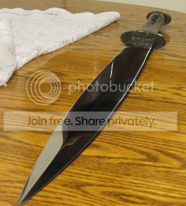

Did you heat treat it?? Anyway I like the scabbard, at least your trying and you should learn a few things from this project. I am working on a double edged sword(21-22" blade, 5160) I have only used a file and angle grinder so far(forged to rough shape), and done all the finishing by hand. by the end of the week I should have something to photograph. I'ts pritty rough, and I struggled big time with the whole double edged thing.

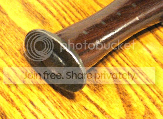

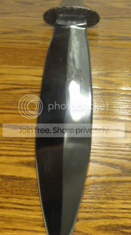

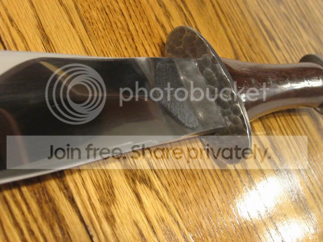

Just something that can be done with bare bones equipment like your working with. Though I did use a 1x42 belt grider for final sharpening. If you look through my pictures you will see everything else I have made lol.

john0270. That really looks nice. I think I will stick to a one sided blade until I get better. But a two sided blade is comming down the road I hope. Thank you for sharing your work and taking the time to post some pictures I like it. John
