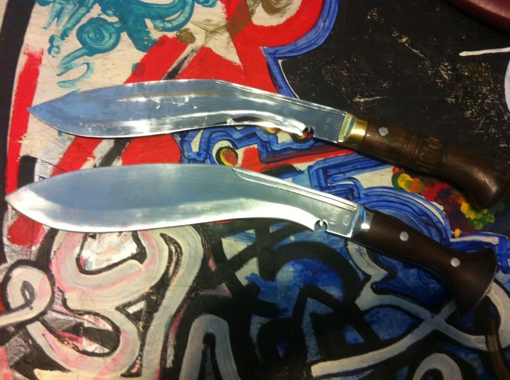

I was lucky enough to score this sweet AK in the deal of the day:
I knew it was going to be a project - rehandling. So I got it in the mail today and think the blade is sweet! next to my Sgt Khadka bonecutter it is looking very good!

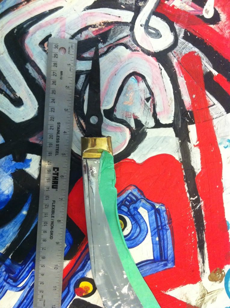

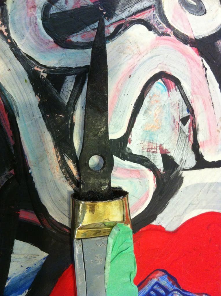

I boiled the handle and it worked! It came off in one piece, now I see what I have to work with:
Its got some nasty gunk up under the bolster that splattered all over the kitchen, but I got it cleaned up before my wife saw.
I have about 4" of tang to work with

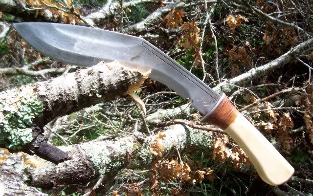

An axe handle or old baseball bat should work, though I think you can find a better looking piece of wood somewhere. Here's a handle I made from a piece of firewood I found in my stack:
from http://www.bladeforums.com/forums/showthread.php/788379-Khuk-rehandle-using-firewood-couple-nails-no-electricity
