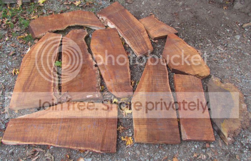

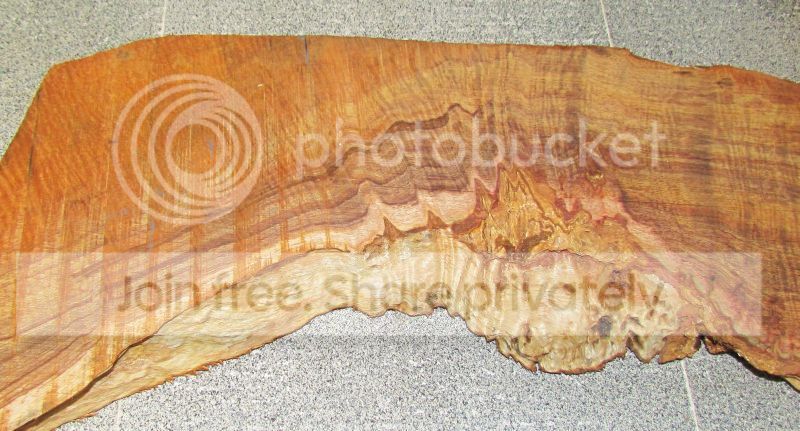

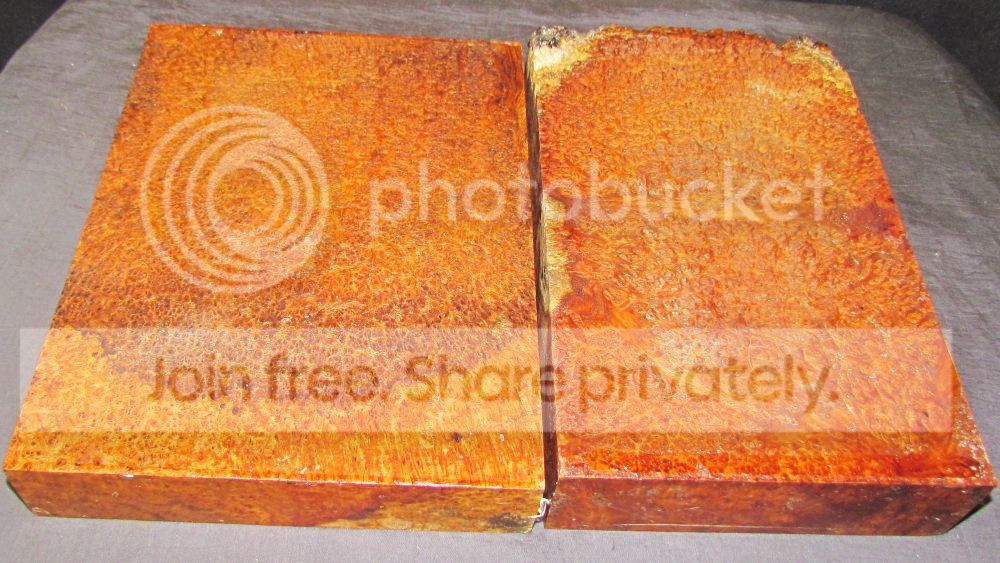

This is the wood that I am cutting up.
The first pieces are in the Amboyna family. Commonly sold as Golden Amboyna but that is not the real name.

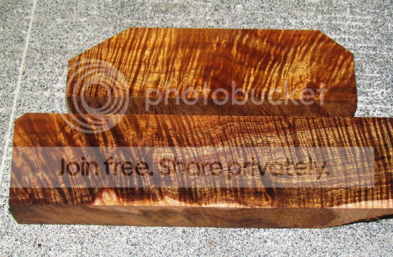

These arrived today. Some very good fiddleback and curly Koa.
The Koa is still wet so when I sand it the grain and figure smear. But I still needed to get at least a glimpse. When dry and stabilized it will look a lot better.

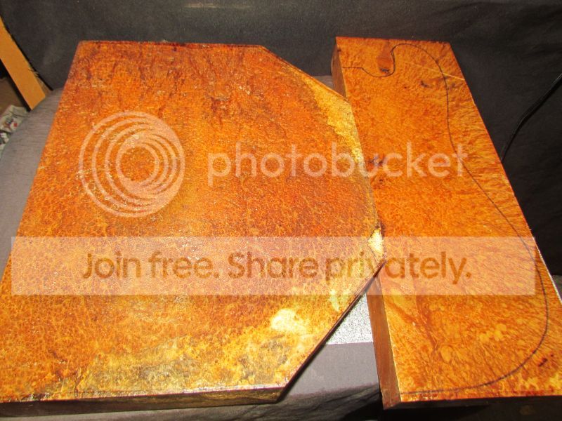

I had been thinking that 5&1/2"+ x 2"+ x 1"+ would be safe for most fighters.
But pieces like this one I might go a little wider to allow for a big, wiggly butt.
