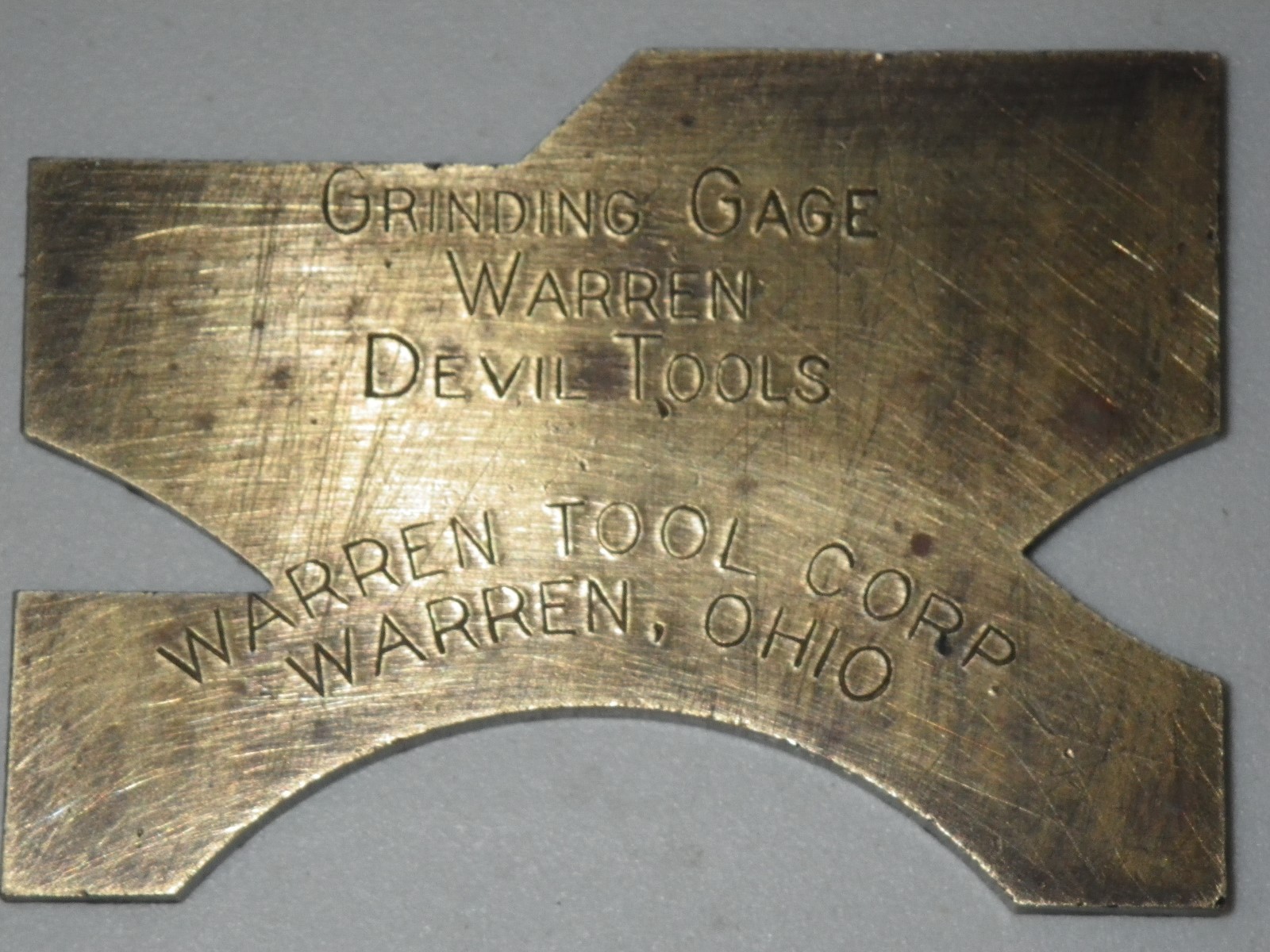

Ever wondered what angle to put on your adze or to dress that sledgehammer face? Here's a gauge you can match the tool up to.
My track chisel head and spike maul fit the gauge pretty closely. My adze is very slightly more acute. The chisel point of my track chisel is a little thin which may account for the chip.
This gauge is made of 1/8" brass and is 5 inches wide. I scaled the image accordingly. If you wish to copy it you should make sure your image is scaled to 5" wide.
I live near the abandoned CMStP&P grade - now a favorite trail. I collect artifacts and tools from this railroad. With the adze & sledge tie-in this thing was a natural buy for me.

Not really. I would have to be newer than 1928 when they added "& Pacific" to the name and likely before the final bankruptcy in 1977.
My guess would be 1930's. This much brass wouldn't have been used during the war. And while the tools were still in use in the 1950's this just doesn't feel like that new of item.

Warren Tool (of Ohio) had smaller versions of that gauge:
The older one is stamped "Grinding Gauge" and "Warren Tool & Forge Co." (the company name used up to 1932, according to the Directory of Obsolete Securities, 1972)
The newer one is stamped "Grinding Gage" and "Warren Tool Corp." (the company name used from 1932 onward), and has an additional cutout.
