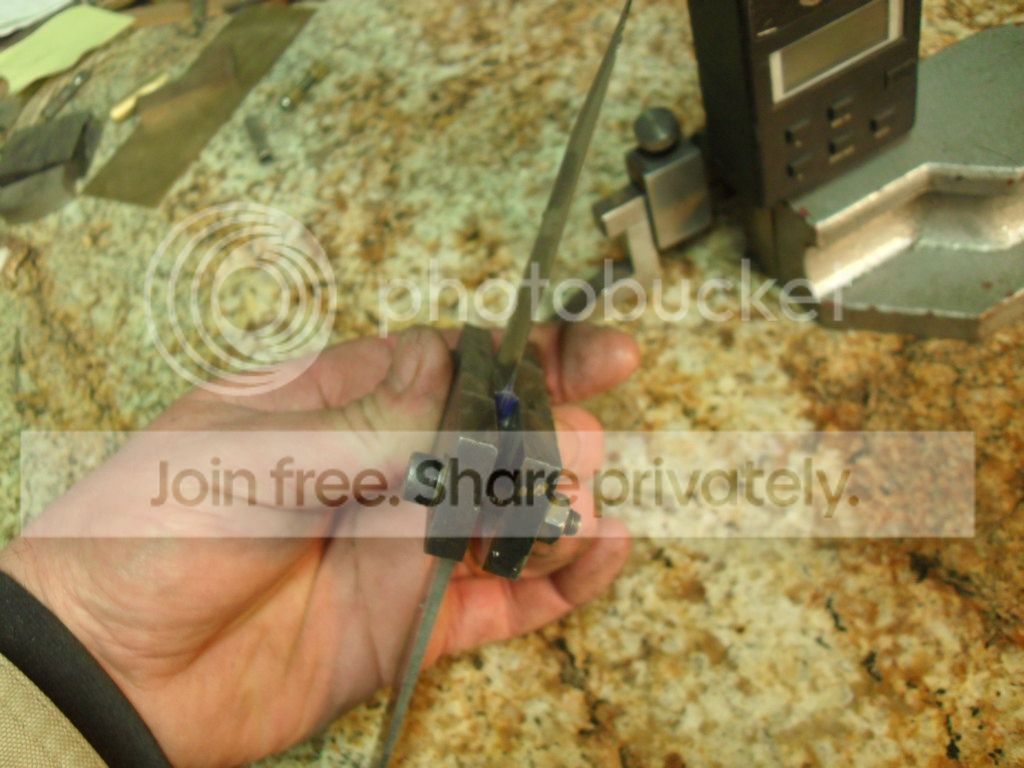

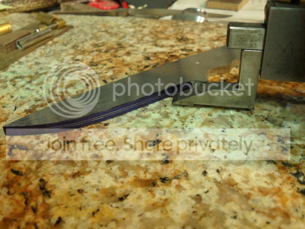

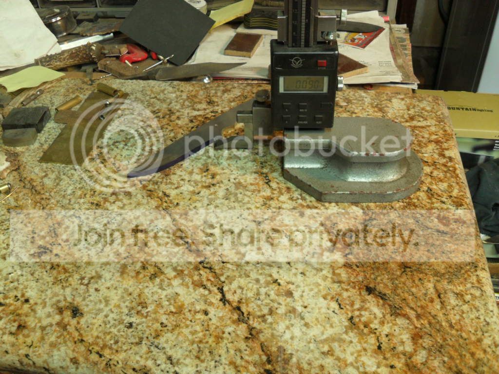

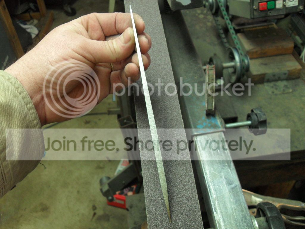

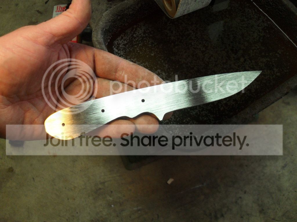

Hi all! Thought Id share my afternoon project, This is a General Task/Hunter design done in SS Damascus. It finishes just under 8.5". I cleaned it down .210, then tapered the tang down to .030, and hollowed it to .021, feels really nice in the hand, I havent commited to the furniture for this one and am open to suggestions. Sorry no action shots on the grinding procedures but I taper like any loveless book will display, and hollow grind with my tongue hanging out! :D
Well here goes:

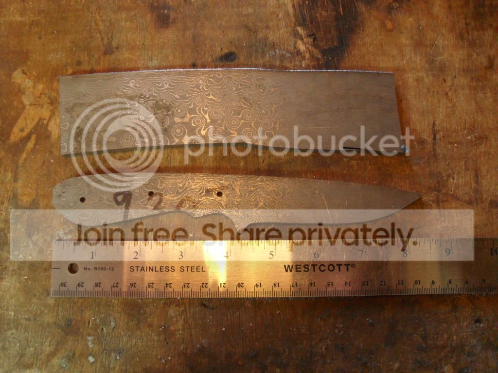

original billet with blank profiled and drilled, I may widen the center hole for a mosaic pin?
Cleaned up in the flat platen
getting set up for scribing
layed out
Locked up in the plunge guide and hollowed
Top view of profile
Side shot
Now I have to wait for Heat Treatment, I can see awesome patterns through the hollow!:D

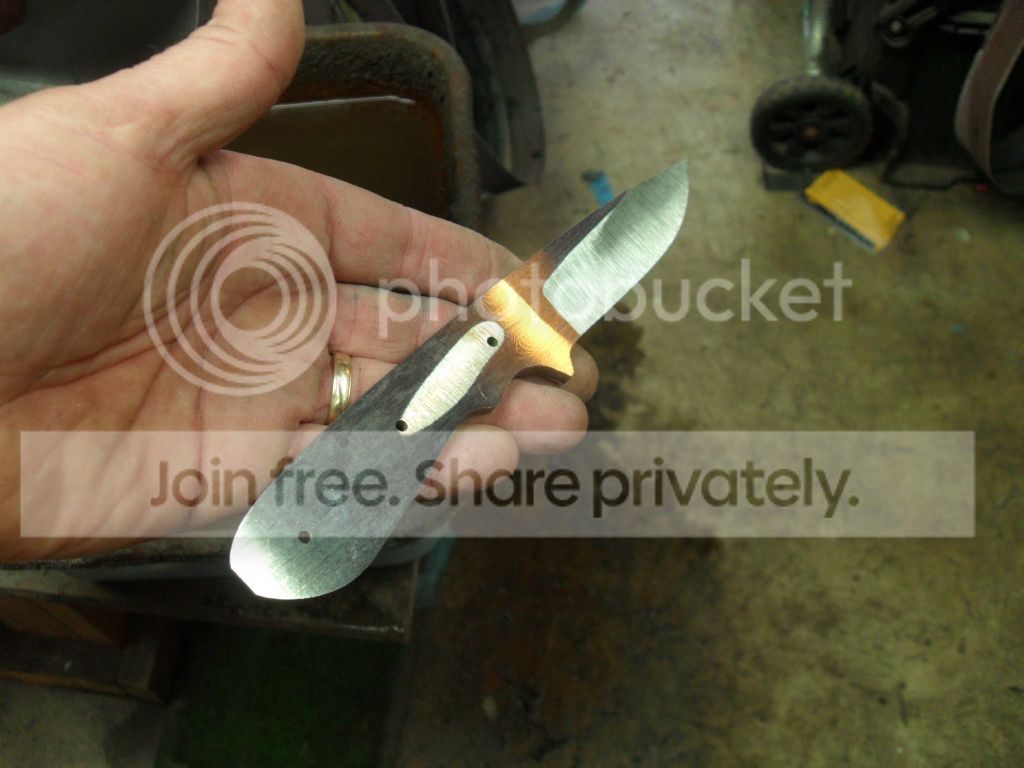

Well I got this one back from heat treat, and picked up some snake wood, and red liners. Starting the prep work on the blade...the fun stuff! LOL
So Ive never etched SS damascus maybe someone can chime in with their experience and recipe to get a real nice etch. Thanks!:)
