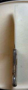

Here’s two of three of my first kitchen set. Parer is being glued up as I post this.
AEB-L .110” stock. Blade ht 2”
OAL - 12”, 7” edge
HRC ~62. Paul Bos Heattreat
Natural Micarta w/ Blue Fiber liners
Stainless pins, West System GFlex epoxy
Balance just in front of first pin, providing neutral to very slight tip bias.
OAL - 12”, 7” edge
