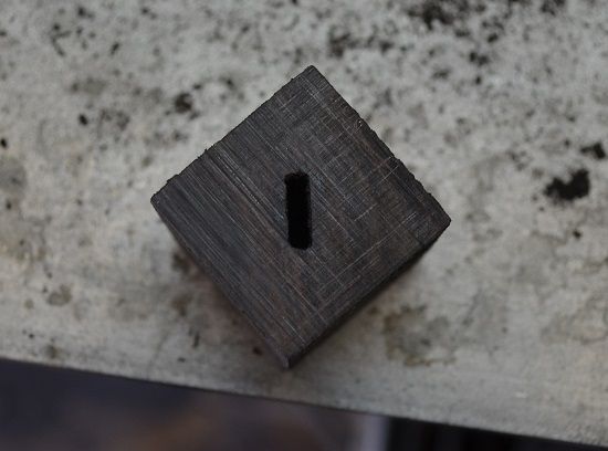

Wa handle is started! I'm using my hacksaw to cut some African Blackwood I have had in my wood stash.

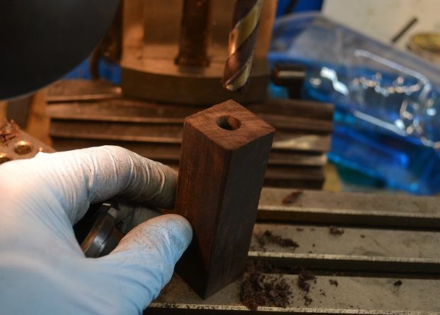

Square up the cut then drill a 3/8" hole about 3/4 through.
Drill some small holes for the ferrule on the other side.
Square up large piece and drill longer hole...

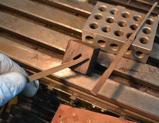

I'm using my Jeweler's Saw to connect the holes for the guard. It now needs to be filed to size.
Getting really close with small files...
