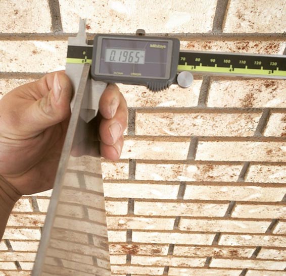

We've been working with Uddeholm Strip/Voestalpine for about five years to get thicker AEB-L. The thicker steel is now on its way to us.
Jeff at Voestalpine worked hard to get us a few sheets to give knifemakers a sneak peek. Those sheets arrived today:
Over the years we've collected your comments and concerns regarding AEB-L. We requested the following when we ordered the steel:
1) The steel must never be coiled
2) The surface finish must match the existing AEB-L (cold rolled)
The steel that was delivered today has an excellent surface finish. You can see the reflection of the bricks in the steel. There are no pits or mill scale. The steel had a slight bow but looked like it had not been coiled.
I owe Devin Thomas for encouraging me to stock AEB-L years ago. No suppliers were stocking AEB-L. I bought one of Devin's kitchen knives and was amazed by the performance. I immediately became a believer and tried to get everyone to try the steel.
We will have billets and sheets available on the website Dec 21, 2015.
Chuck

I'm glad to hear that. My HT guy has told me that although 13C26 is almost the same chemically, he hates working with it because it almost always warps on him... causing a lot more work and headaches on his part. His opinion was, that's because of how it's coiled-up at the mill, possibly when still warm.
