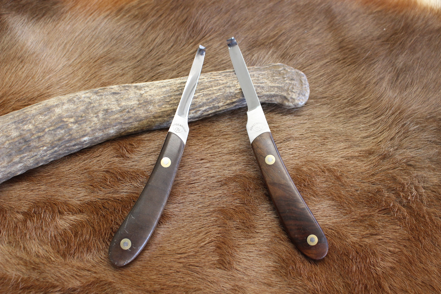

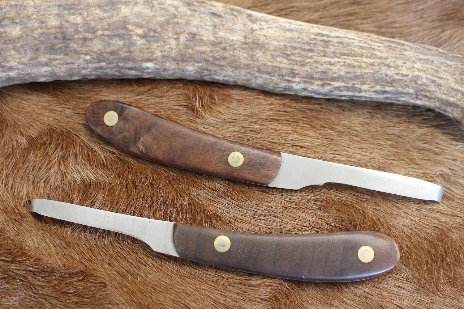

Over the last couple of years there have been numerous threads here on just how tough is AEB-L and how well does it hold an edge. Thought I'd share this with you. Few days back I come home from the ranch and find these two hoof knives on the bench. This is a matched set (right and left handed knives) I made for our local horse Vet who is also a good friend. I made these for him in Aug of 15. He estimated that he has used these at least once a day since then. A Vet uses hoof knives for digging out abscesses in a horse's hoof, not an uncommon problem. He was here last Jan doing so to one of my horses. I asked him then if he would like me to resharpen them and he declined saying simply "they don't need it." Hard to think of a more edge dulling medium than a horses hoof with all the barnyard muck, gravel, sand, dirt, mud manure etc. Let alone the hoof is pretty tough stuff even if its pristine (and they never are). Think about it this 1200 lb animal runs around carrying my 40 lb saddle and my 230 lb butt and then I rope a 2,000 lb bull going the other way and he can still walk afterwards. Tough stuff. So now Oct of 16 they finally needed resharpening. 1/8" AEB-L stock @ 63 RC with heat treat done by Peters. Turkish Walnut handles and Loveless bolts. I have declined making any further hoof knives cause these "bitc...." wanna jump off the grinder and bite ya. Anyhoo:
Still got some dried on gunk.
And then after sharpening and ran the handles over a clean buffing wheel.
AEB-L is plenty tough and holds an edge. Works well here.
Very cool. May I ask how exactly you did grind the hooks after forming them? I've been meaning to make a couple carving knives of similar shape but haven't sorted out how to do that on the inside of the radius.

kuraki I did most of the edge shaping and grinding pre ht and pre shaping of the pig tail. Post ht I cleaned it up using a small chain saw stone in a variable speed grinder on pretty darn slow. Then buffed with a felt wheel and green compound. Not only hoof cutting but hair splitting. When he or his assitant use them they wear kevlar gloves. And definitly no protractors huh Cody? Thanks you sir. He had lots of imput in the design. He had quite a few different custom hoof knives forom different makers, many of which he liked. However none of them would hold an edge as well as he liked and that was the primary goal of the project. Might of got him spoiled cause he has probably 10 of my belt knives, a set of steak knives and several kitchen knives. Thats true Zidfelts however thats what he was trying to get away from with this set of knives.
