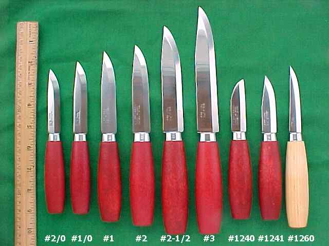

As far as aftermarket kardas go, several folks have voiced satisfaction with using the inexpensive, but excellent, knives from Mora, Sweden, as a karda substitute. They should be reasonably available in the UK.

As Sarge mentions, the Moras and other small "Scandi" style blades make excellent kardas. This puukko was ready made, but you can get the blades and do your own handles:
Brisa has a good selection of this type blade.
