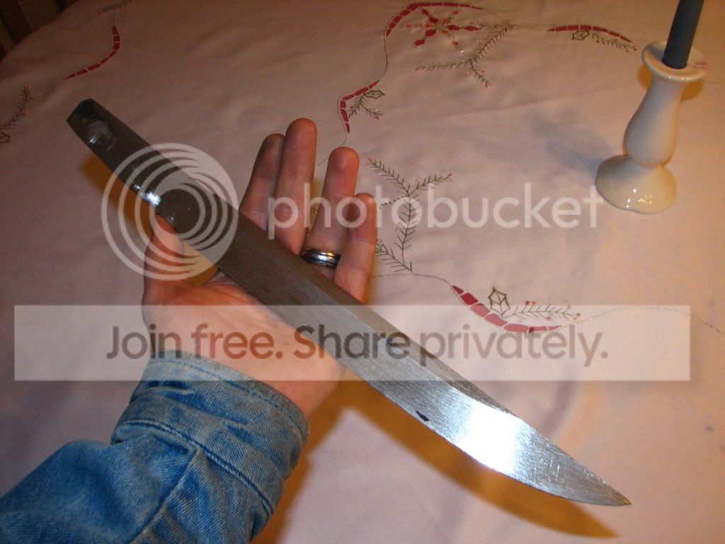

okay... so i have my w2 tanto..
i havent hardened it yet... but assuming that goes as planned...
what is the best way to remove the rest of the stock?
before i ran it in my grinder but that is no longer flat... (part of the reason i am going to hand tools)
so i cant use a file because of the hard back... what do i use to remove thatlast stock before i start polishing?
and how "sharp" do i get it before polishing?

here is a pic of the knife just after filing (the sharpie marks are where i need fine adjustments

I always grind after heat treating, to remove decarb, correct any warpage, and get the grind lines the way I want.
perhaps just use files?
I dont really know, I always use my belt grinder.
If I were doing this all by hand, well...
I guess I would use files* to get down to the place where I could start to use stones and the polishing.
Some guys make a type of steel scraper that they work with both hands.
*The best type of files I have ever ran into for getting rid of steel fast is the Nikelson MagicCut files

In the end, I think you are going to need to use files as you can burn or crack the hardened edge with a fast moving grinder.
I have done that myself.
I know that a file seems to not want to bite, but I dont know what else to use.
In the Wally Hayes "KATANA" video I think he used files at this point.
After you get the edge almost sharp, Wally Hayes switched to sandpaper and a long two-handed sanding block.

If you haven’t hardened it yet the blade should be soft unless it was not cooled slowly enough. It could have been overheated and quenched wile grinding also. This will cause harder spots in the steel. One thing you can do is anneal the blade again or you can get a block of wood and wrap sandpaper around it and go to work.
The thickness of the edge should be about half the thickness of a dime before quenching. Much thinner and warpage may occur.
To repair the platten on the grinder use the same methods used to make the blade flat, files, sand paper etc. Another option is to get a piece ceramic glass and glue it on the steel platten.

You can buy compounds that coat the steel and prevents oxygen from reaching the surface. You might be able to get similar results by coating the blade with really watered-down clay. You don't want a real thick coating at the edge, or it won't get hard there. (obviously)
I'm not sure I followed all the questions and answers going back and forth in this thread, BUT, let me mention one more thing. (Mike Arsenault touched on it above.)
After HT- that is, quenching to achieve full hardness and then tempering to reduce full hardness to usable hardness- you're right, you will have a tough time shaping with files.
However, abrasives, especially Silicon Carbide (wet or dry) paper will still remove metal just fine.
If you've got some flattening to do, get the coarsest paper you can find (80 is probably too fine, 60 will still be time-consuming, 36 or 40 is your best bet) and wrap it around your file. Then go to town.

The simple solution is to wrap a piece of sandpaper around the file. A good sandpaper will work on the hardest steel and the file provides a flat surface for the paper.
Several things.
First - Once hardened and tempered, it will be much harder to remove metal and SCRATCHES. If hand finishing the blade, sand it to at least 400 grit prior to HT.
Second - If hand finishing, go a little farther toward final thickness..020-.030 at the edge.
Third - Use abrasive stones to take the metal down after HT.Clamp the blade to a board mounted such that you can sit of stand next to it (clamping the board in a vise works, use a C-clamp to clamp the blade). A coarse/fine bench stone will work, as well as diamond "stones". Wet-or-Dry paper wrapped around a block of micarta or hard wood takes over next. Continue until it is at 400 grit and shaped to the final thickness. The edge may well get sharp during hand finishing ,so be careful. Blunt it with a stroke of two of a bench stone to keep from cutting yourself and the sanding paper. Once the blade is at 400, switch to wet paper, going back to 220.The strokes should be in only one direction - smooth and long. Continue on up to 2000. The blade will have a fine finish at this grit. You can continue to finer grits, but it is probably unnecessary. The edge should be sharp again by now. To polish the blade, finish the edge, (and bring up the hamon if there is one), you glue a piece of hard leather on a 10-12" long block of hardwood. Charge this with flitz , rouge, or whatever you want as the final polish (Flitz works very good). Start with slow,smooth ,long strokes, taking your time. Recharge the polish often, wiping the excess from the blade with a soft cotton cloth every few minutes. BE VERY CAREFUL WHEN POLISHING THIS WAY. The edge will get unbelievably sharp and can cut you to the bone with one slip or bump. So stress the word SLOW .
Fourth - Blades like your should have a convex grind (called Appleseed in Japan) to allow for the sanding and polishing to do the entire job. Done right the blade is one of the most awesome looking . If you are going to be using this in the woods and hacking on tree limbs, then I would suggest that you re-sharpen it on your normal bench stones (or whatever you use to sharpen)after the final polishing (several Japanese blade polishers just fainted!) . This will add a secondary bevel that will hold up better to the use/abuse you may give the blade. The true hand polished Appleseed edges are made for cutting flesh with the minimum of resistance, but not for chopping wood.
