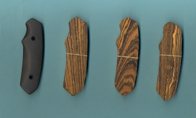

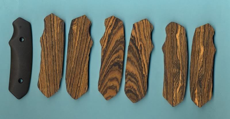

I did some also http://216.26.177.84/forums/showthread.php?t=535636
John,
Those scales are great looking.:thumbup: What's the wood?
Also, you mind discussing how you recessed the screw holes? Forstner bit? And did the the contouring?

The wood is Bocote. For the details and lessons learned see post #9 in the link above the photo's. As far as the counter bore depth. I just set it so the top of the screws was no longer above the scale.
You all should note that the rubber handled Alpha folders are screwed to the liner. The wood Alpha handles are screwed to a threaded spacer. I'd suggest you remove the handles from you project knife before you start to see what you are working with. I made three handles all the same and the last one I was going to replace was a brown wood...it had the spacers so my counter bored scale did not work:(.

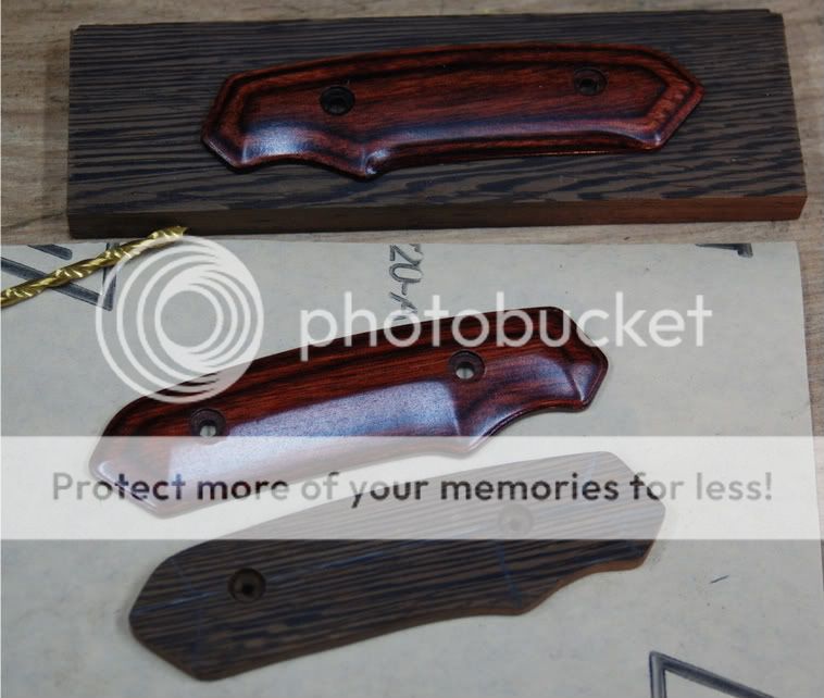

I think I'm going to start this project today. Earlier I replaced the rosewood with rubber scale on my 277 Alpha. Using those rosewood scales as a guide, it looks like the screw hole is 9/64ths and the recessed hole is slightly larger than 9/32nds...very nearly 5/16ths. So the search is on for a Forstner bit in 5/16ths. I probably just should buy a nice set of bits. More later today.
OK JB per your request to show as I go, this is the pilot project. I'm using African Wedge I got on one of those buy 4 sets of scale and 2 of 'em your not sure you want kind of deals. So if I screw it up I won't be pissed off like I was when I frigged up my really nice piece of ironwood a while back.
I haven't drilled the holes yet just the recessed area for the head of the screw. See the pencil lines? We'll see how I do with the contouring. I'm gonna go for an exact copy or as close as I can. I still have about 1/32 extra on the belly side just to work with. That why the point area near the finger groove looks a little rounded. More tomorrow.
