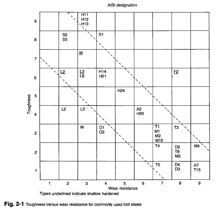

I was reading a book on tool steels when this image set me aback...
I read discussions on super steels and like, but I don't recall much being said of AISI F2 steel, yet it strikes me as having properties that would be idealy suited for non stainless fixed blade- according to this chart it seems to be on par with D2 for wear resistance and with L6 for toughness. It is reported to be hardenable to 67-69 HRC range (manufacturer data on alloy that seems to be still produced in Germany recommends 67).
I would be grateful for any info, real world expiriences, opinions on F2 and such like. TIA :-)

F2 is a very good knife steel. I obtained a small amount of it from Carpenter in the mid
70's. At that time, Carpenter stated that no steel was as wear resisting as KW (their name for F2)...
In my experience with it (rather minimal), I'd say the diagram above is a bit off...F2 being
a bit more wear resistant, and not quite as tough (shock resistant) as shown.

Also....F2 and L6 might test out about equal (per above chart), if the specimens are
round stock, because F2 is a shallow hardening steel, like W2/W1, while L6 will
harden through. On a thin edge, the results would not be nearly equal.

Good point about specimens, Russ, I was wondering about it myself when I noticed that F2 is shallow hardening. (BTW, how would that fact reflect on stock removal vs. forging?)
Jens, ASM tool steel handbook I took this graph from has some HT info which I may post if it's of any interest, and some can be found on the Ossenberg website ( http://www.edelstahlwerk-ossenberg.de/fileadmin/PDF/Kaltarbeit/1.2453.pdf )...
Wolf. With F2, you have to be very careful not to overheat while forging, due to the tungsten's
tendency to promote crumbling at high heat. Other than that, the differences between forging
and stock removal methods, are the short lived abrasives, and the additional thermal treatments
needed after forging.
I don't think it is really possible for any alloy to be heat treated to >60rc and still being as tough as L6 while having wear resistance of D2...
Yep, Russ said it wasn't as tough in his experience... But, *ass*uming similar drop in toughness when through-hardened as graph shows for L2 and L3, I'd say it would still be tougher than O1 and O2, and level with A2 with better wear resistance (which wouldn't be affected)... Just my (un)educated guess, I must add.
