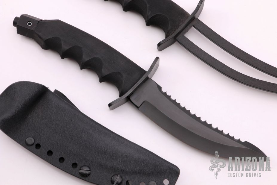

In regards to Al Mar's version there are three variations:
- Uncoated, black handle (the most common)
- Black coated, black handle (somewhat common)
- Black coated, camo handle (pretty rare)

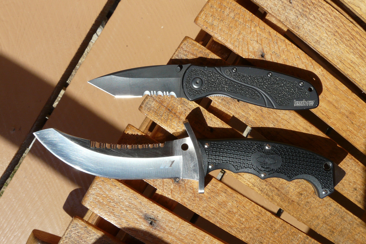

When I first held the Warrior Knife, I immediately thought that something was wrong. Where is the complex COBOL programmed design study? Why isn't it feeling like an extension of my hand, something as quick as a though? This is meant to be the perfect fighting knife, why doesn't it feel perfect?
That's because the knife is a beast!
I do not have a scale handy at the moment but the thickness of the blade is 6.5mm or 0.25-0.26 inch. It's almost as thick as my Becker BK-2 which is the definition of a sharpened pry bar!
The reason for the thickness is that the initial design called for ATS-34 steel (it was an absolutely excellent steel in the 90's) but G.Sakai somehow managed to get it replaced by AUS-6 thickening the blade to compensate for the use of a lesser steel and this had acascading effect on the overall knife design.
What a tragedy because even when holding it it and handling it you feel the weight of it of course but you also feel that any other design would have felt much heavier with the same weight.
And this an indication of the Knife's great potential. It is balanced just below the guard and in such a way that tremendously help in managing the weight when recovering from performing a big circular motion. This also makes it less than ideal for chopping as you would need a balance that's much closer to the tip but that's okay as that wasn't part of the design brief. Chopping motions are slow. Slashing and stabbing are fast.
Nevertheless this knife is coming so close to greatness. And it is endlessly frustrating to realise that it's not and it won't, all due to the normalisation of deviation (if you know you know)
The second issue is the guard. It is thick which goes well with the beast aspect of the knife but also curved towards the hand which is great to act as shield but would dig into the wrist when violently stabbing in the ice-pick grip. This could be one of the reasons why Spyderco's version of the Warrior went the other way around.
Last but not least, the handle. It is great and I can see why it was so complex to modelize. When you hold it in the proper position the knife literally locks up in your hand and you feel that it won't role in your hand regardless of the violence of the impact you would feel when strongly stabbing or slashing. In that regard it is amazing. Furthermore the thick nylon handle plays the role of shock absorber amazingly well. But it is once again not perfect. You need to perfectly line up your hand in a certain fashion to fully get the ergonomic benefit of the handle and somehow my pinky never feels fully comfortable especially in ice-pick grip as the handle gets thicker the closer it goes towards the guard.
Great for hammer grip not so great for ice-pick grip which is ironic considering the initial design brief.

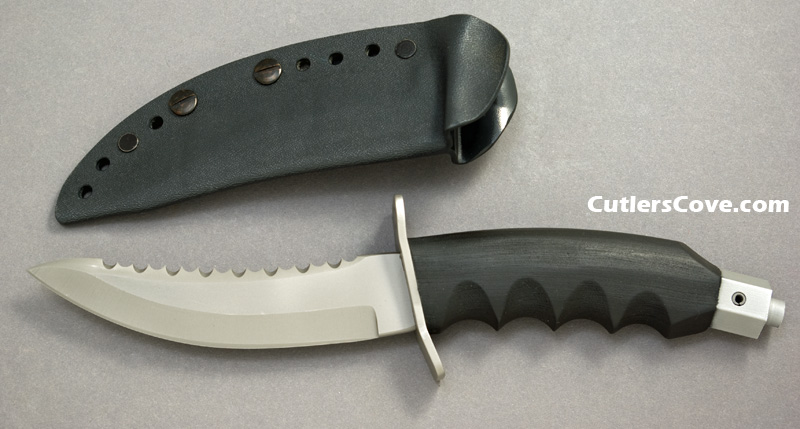

Nice write up my friend! I love me some Al Mar knives, always have since I first layed eyes on them at Excalibur in the local mall back in about 2006. They had a sweet collection of Al Mar knives and I lusted over them every time I went. I'd go to the mall just to look at them. I've only ever owned a SERE 2k and a mini SERE 2k, but they are one of my favorite knives ever made as well.
It certainly has lots going for it, but as far as slashing goes....gee, the Wharncliffe design has been shown to cut pretty well. One of hte things about the Warrior design is that if oyu hold it in icepick grip and stab, the edge will always be pointing at the target at a good angle for penetration, which isn't true for other designs. So I think it has an advantage there.
I'm guessing the edge bevel not extending all the way to the ricasso is just an operator error. Looks very obvious though. Q/C asleep that day?
It's by design , maybe to allow a finger to be hooked around the guard .

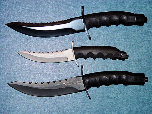

Congratulations on your Warrior acquisition, boudda0357! And thank you for your great photos and your thoughts on the design. I really enjoyed your write-up!
I won't delve too far into the best fighting-knife attributes, as I'm guessing that the moderators would prefer that we reserve that for Practical Tactical discussions. But suffice it to say that martialists and industry designers have been seeking the "perfect fighting knife" for generations. The fact that they keep coming up with new approaches shows that "perfect" is a continually moving target, with a different definition for everyone. I would also argue that the generally rapid disappearance of dedicated fighting knives from the company catalogs tells me that most people just aren't interested in them, for a host of reasons.
Interestingly, your observations regarding the Al Mar Warrior's failings are the very things that Wanner and Taylor also objected to. You will find that they corrected all of those attributes (except, regrettably, the rear-angled guard) in their REKAT Hobbit Warrior.
REKAT also made its own version of the Warrior called the Gijan Warrior. I've never held one, but it strikes me as more of an homage to Al Mar (and perhaps an attempt to recreate the Warrior without its weight/bulk shortcomings). It was short-lived and was supplanted by the superior Hobbit Warrior.
The Hobbit Warrior is an amazing knife that feels alive in the hand from the moment you grasp it (at least it did for me), just as you were expecting from the Al Mar version. If you're looking for your next knife, look for an old REKAT before you try the Pygmy Warrior. I don't think you'll be disappointed.
-Steve
-Steve
I see what you mean TC. I think it's actually part of the design as every other Al Mar Warrior is this way but not in the same way the DocJD means.
DocJD if you look above the ricasso and below the bottom of the edge there is another unsharpened space that looks like it should have been sharp. You may want to check for coated variations on google images and you will see moe clearly where the edge stops.
