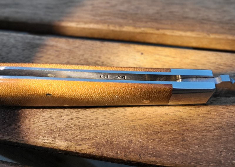

I just posted these photos that Eric @ea42 shared with me while he was working on the 2024 Guardians knives in the Guardians thread, but I feel like they should be posted here as well. Those of you who follow both threads will have to forgive the repetition.
This was the micarta roll/cylinder that was used for the handles. As you can see, it started out looking a bit rough, and I’d be lying if I said I wasn’t at least a tad anxious about how the end result would look, but you’ve to trust the process and, of course, they turned out great!
After cross-cutting the cylinder into disks, Eric ended up with a couple pieces that he couldn’t use due to voids or breakage. This was a scrap piece that he partly polished to see what the color and texture would look like.
Here’s one of the stamped liners before assembly. Rather than stamp all five characters individually on every knife (and for a cleaner execution), Eric ordered a stamp from the guy who makes his tang stamps.
Eric said he likes to glue and pin the handle material to the liners. Here’s the micarta being glued to the liners.
Here are a couple pics of the assembled knives during the grinding and shaping process.
This one is shaped and ready for buffing.
And finally, this was the first bunch of finished knives.
Thanks again, Eric, for making these knives for the Guardians, and for sharing these pics of the process with us!![]()
