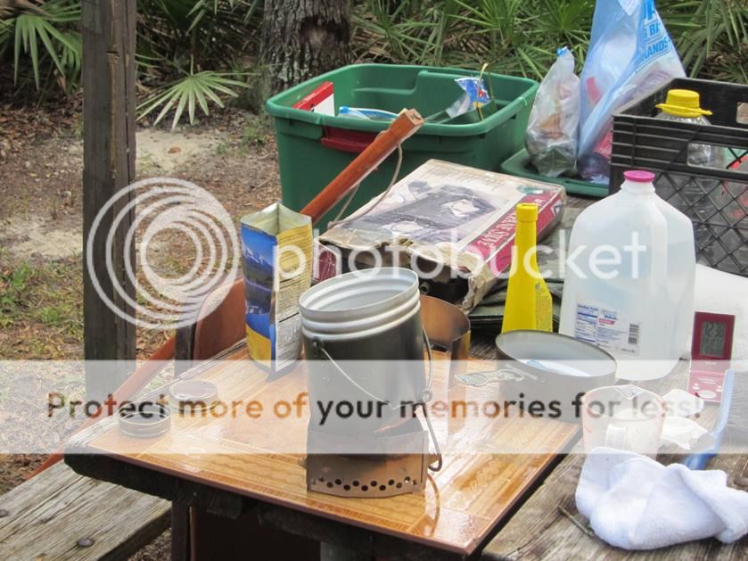

I had not used my Trangia yet this year. I took it on a three day trip to the Ocala NF this weekend. The bottle of HEET I used seemed to really produce a lot of dark soot. Normally, the yellow bottle stuff burns pretty clean.
