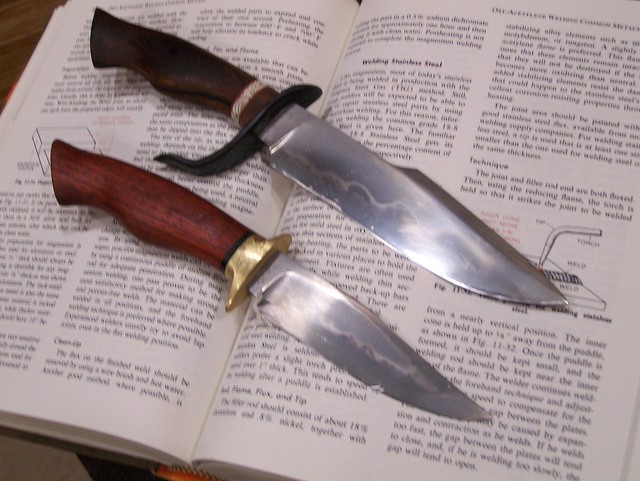

Jason, I have been getting some great hamons in 1095 when I keep the austentizing temp below 1475f. Since I use a forge, i do a 5-10min soak at 1465f. And quench in DT48 (about the same as parks50.) if I use 3/16" or thicker, I don't even use clay. I interrupt the quench when it feels right. I don't know how to explain it, there is a change in the feel of the sizzle, out for 4 seconds, then back in to finish the quench. The hardened part of the blade is Rc65 or better, so no concerns with hardening.

It has little to do with the carbon content. The deepness of the hardening is the most important element, then temp, time, quench speed, along with geometry. 15N20 isn't supposed to show a hamon, but the manganese content of Aldo's 15N20 is about half of the normal spec (Manganese is the element most associated with depth of hardening, but there are several elements associated with this.) Manganese less than 0.5%, (0.4% preferably) generally increases hamon potential. 1080+ has 0.45% Manganese, whereas 1084 generally is 0.8+%. O1 is 1-1.5%= deeper hardening. W2 is 0.3% approx, shallow hardening, 1095 is about 0.35% Manganese.
One is 1095, the other is 15N20. Want to guess which is which? The manganese content is within 0.05% or so in each.

Actually Aldo has his 1084v custom melted to his chemistry specs by a small mill in Germany. I am not sure where Kelly gets his from but they are definitely different materials (I have both in my basement right now) as stated it is not carbon, but manganese that has the biggest effect on your hamon, carbon is obviously necessary but it is not the only element in play

In all the time I've had it here I have never taken a close look at the certs. on the 1/8 and 1/16 15N20 I had rolled.
C .74 Si .28 Mn .35 Cr .095 Ni 1.97
Maybe we should take a look at getting some thicker sizes in. :) Both hamons are beauties. I'm guessing the shorter blade.
As for the W2 we are hoping to get the Mang at about .20. We should know in a few weeks.(This time it was all tested before it went out!)
Aldo
Aldo
Yes, its the shorter blade. It was accidental with no clay. I was experimenting with austentizing temps, and this one was a low temp 1465 austentize with a 5 min soak into DT48. After the first 350f temper it was Rc63. Really happy with the results! The grain is really fine, it takes an edge almost like O1/52100 does. I really like this steel! I would definitely get some in 3/16" or 1/4" if you got it.
The other nice thing about 15N20 is the patina. It comes up pretty quickly do to the nickel. We have a few guys making kitchen cutlery out of it and they are getting great results.
+10 on this. I have made about 10 kitchen knives out of the thinner stock, and they perform great. I can get a little more out of 52100, but it's a lot trickier to heat treat. My wife's favorite knife is 15N20. I did a few chefs knives with it for Christmas presents and they were well received.
