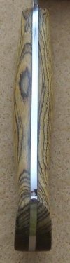

Blade-5 & 3/16 long, 1 & 7/8" wide at heel, & 3/32" thick with a distal taper. Full flat grind with a belt finish. It was ground to .005'"-.006" then convexed to sharpen. Yes its sharp!
Handle-Stabilized Bocote attached with brass Corby's and Acra-glass epoxy.
Heat treat-Three thermal cycles for grain refinement, fully quenched to a hardness of HRC 66-67, & triple tempered to a working hardness of HRC 61-62.
Price-**SOLD**
Comments & questions welcomed.
Thanks for looking.

Great design. Patton has one somewhat similar that I ( ahem) borrowed and use down in my rancho where I cook quite a bit. Plenty of room there for knuckles. Very important for cheffing.....is that a word ?
Thanks Tilaran, its big enough for most "cheffing" chores but still handles nicely. It does have knuckle room, especially with a pinch grip. If someone wants to make a reasonable offer send me a PM or email.
This one is sold folks. If someone wants one similar to this one send me an email or PM. Thanks Russ.
