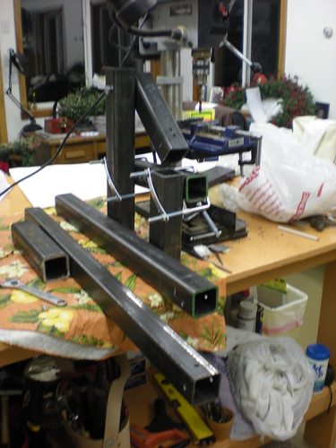

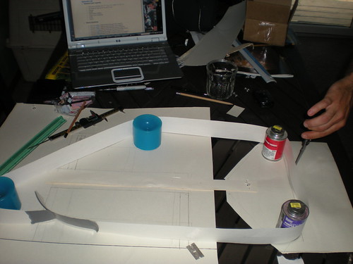

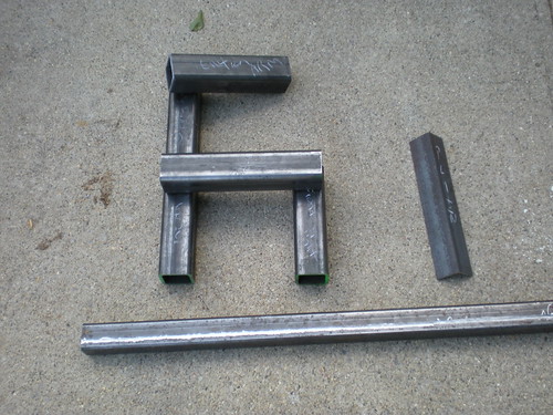

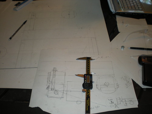

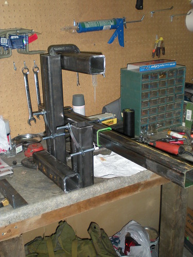

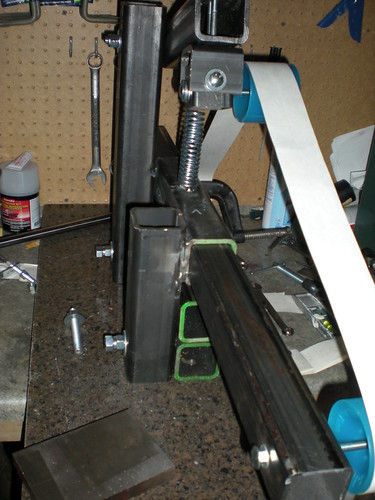

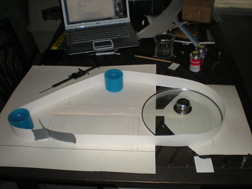

After lerking and asking a ton of questions I should have never asked I'm really,really close to calling my grinder done. It's plenty overkill but better too much than too little. I'd like to thank everyone who has commented on my posts and helped me out. the design is a lot like the No Weld Grinder but I found the measurements,tube size, and designed/converted everything myself. I stared with the kmg clone plans drew them up on some mondo paper and figured out how I would make it out of 2.5 square 1/4inch tube. enjoy:
what do you think?

Lookin good! You'll have to post up the plans once you're all done for those of us less mechanically inclined... ;-)
Good looking build! I'm going to steal a part of it when I finally get my grinder build started.
